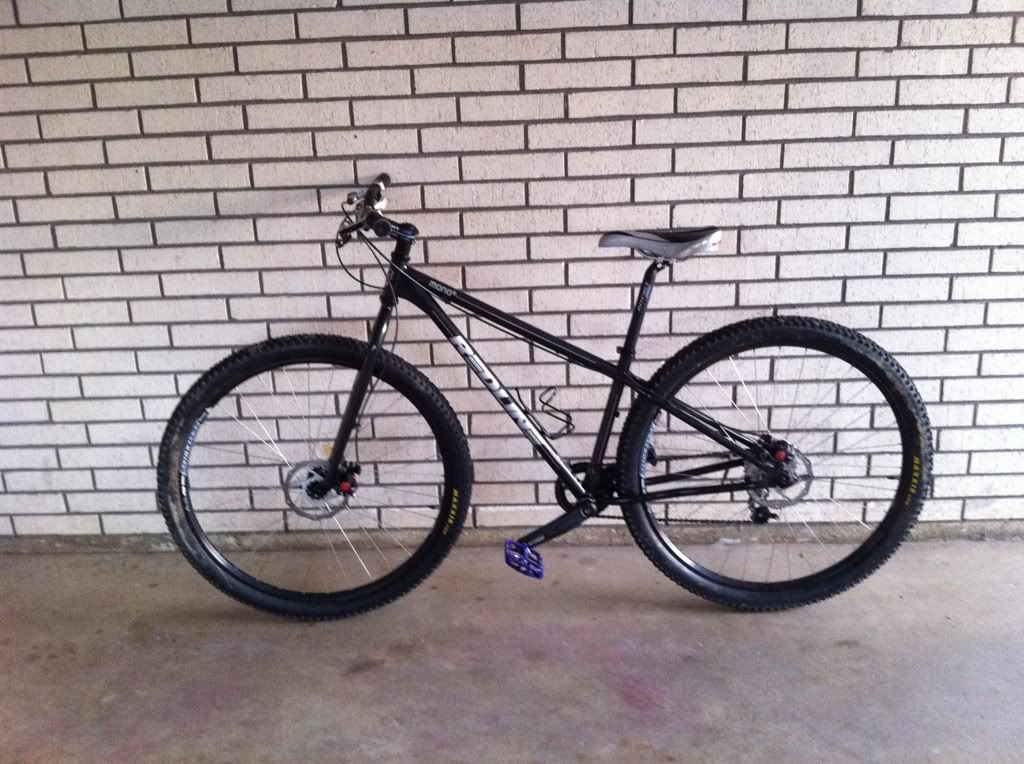

    Will I got the bike now and took it for its first ride this morning. Only 3.5 miles but enough to get the feel for it. Im pretty happy overall, but I think I need the bars up a little higher for my taste and comfort. My hands also were going numb during the ride, I figured this was because I was leaning pretty hard on them. What would be the best way to do this? The bike already has a couple spacers on the stem so I cant add to that. It still has the stock bars and stem ritchey pro bars it looks like a 25-30mm rise, and ritchey pro stem looks like 90 mm with 8-10 degree rise. I did some reading and found that the stem would be the easy route. If I went with a higher rise bar (2-3") what else would be involved? Could I reuse my grips or would I need new ones? Sorry for all the questions.
    and here are a couple pics.

    Yes...you can reuse them. Numb hands is a very common problem that could be cause by a number of things. One could be too much weight on your hands like you say, could be bad grips, maybe you need padded gloves, improper riding technique, gripping too hard, just need to get used to riding, ect...but yeah, a new stem would be the easiest route to raise the handle bars but in all honesty...it looks like they are pretty high to begin with. If you look at most people's bikes you will see the seat is even with or even higher than the handle bars. But of of course nobody says that's how you have to set your bike up...its all up to you and your personal comfort. It may also pay to be fitted for your bike...I know it made a huge difference on my road bike.

    I did notice that most bikes are like you said seat even or higher, Ive been moving the seat around a bit to try different things out and this seems to be the most comfortable. My riding position was a little better with the seat lower, but my legs were too bent. I believe its because I have shorter arms so Im leaning more forward than normal putting most of my weight on my hands. The grips seem to be decent they are yeti grips and arent to hard or soft. I think Im just going to ride it for 2 weeks before I start making changes so I can get accustomed to riding.

    I would try a shorter stem first before raising the bars, something around a 50-60mm. For numb hands Ergon GP-1 grips haved saved me, used to use ridiculously padded gloves which helped only a little. Now I don't even need padded gloves at all.

    thanks for the advice guys. I commuted a few days this week, and have some where around 25 miles on it so far. Im definetly getting use to riding it but still felt too stretched out, so I ordered a ritchey pro stem 30 degree 70mm. I was able to get a small test ride in after installing the new stem, and I am very happy with the results. The bike fits me like a glove now.
