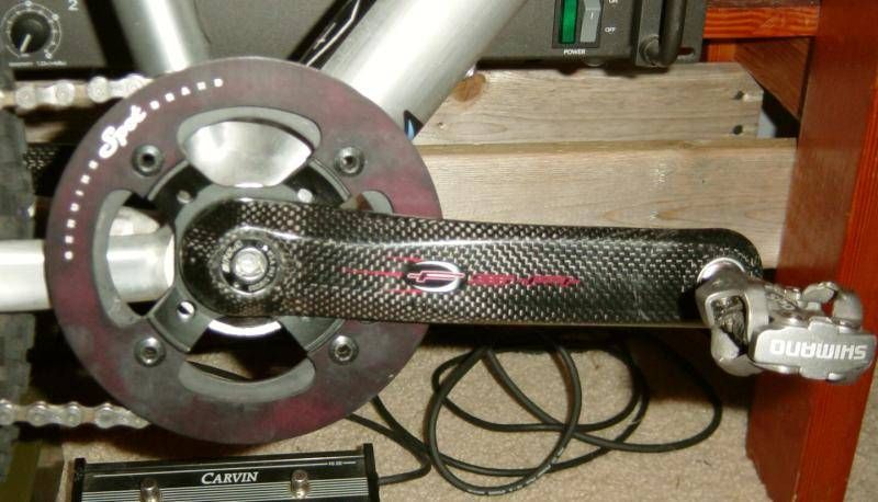

    The best crank set I've used is a FSA carbon with a octalink BB. At 250lb it is the stiffest setup I have ridden. I also run a FSA K-force on my road bike, with no problems.
