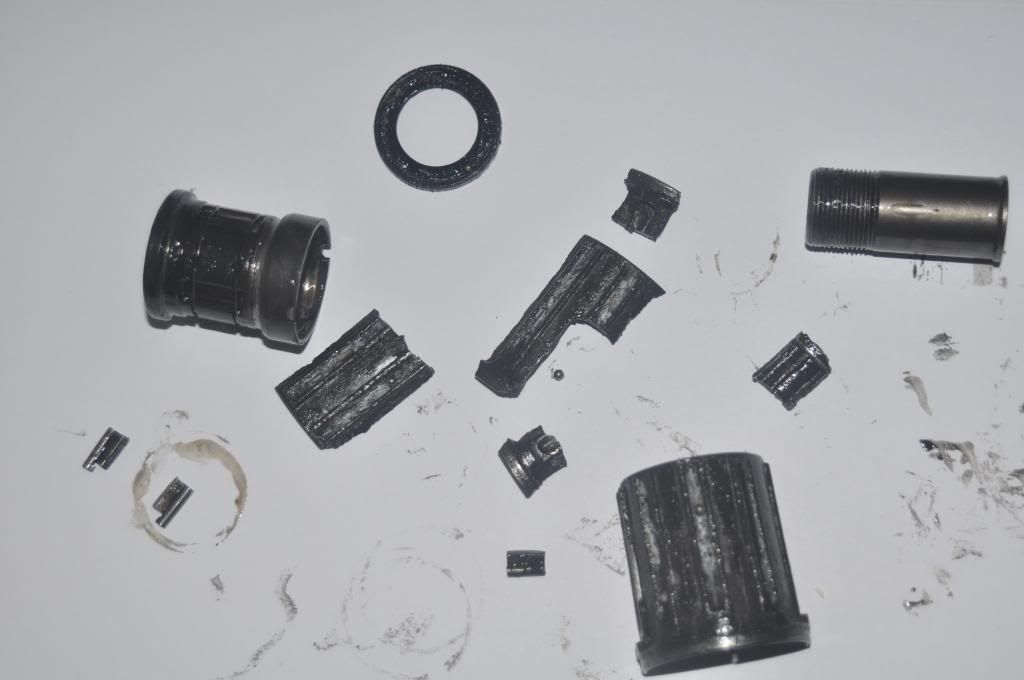

    I need a Clyde-proof rear hub/freewheel!
    So I've just nuked the freewheel in my new(er) Shimano XT hub. Something about the pawls bending backwards or something. This is the second one this year, and my 4th or 5th over the past few years. The bearings are finally shot too after they have loosened several times.
    I'm looking for a good, durable hub that offers the best "bang for your buck" performance. I'm not looking for the lightest, loudest or most expensive, and I don't want a hub that requires proprietary tools to adjust or rebuild.
    Suggestions?

    TooTallUK: Yes, it is usually a failure due to shock load. The Shimano XT rear hub (specifically, the freehub) is a good product, but it is the weak link in my drivetrain for my riding style. I ride very technical trails and Trials, as well as racing DH and Enduros. I'm a big boy, and I expect to break stuff. Just looking for something stronger/more reliable than the Shimano XT unit.

    I weight 100lbs more than most racers and I've never broken a rear hub that way. I know many other heavy riders who ride far more than me and far harder and they don't do that either. As I said, identify what it is you do when riding (shock load?) and stop doing it. That failure is not normal.
    Shimano freehubs have failed on me in the middle of a steep climb more than once. Not from shock load, just mashing down on the pedals. I'm not someone to slam into my drivetrain, and am considered to be a smooth rider, and not abusive unless you consider hauling my oversize carcass around to be abusive.
    You are correct about this: " identify what it is you do when riding (shock load?) and stop doing it."
    I figured out what it was that I need to stop doing when riding: Expecting Shimano freehubs to last while I ride up a steep hill.

    I have 12x142 XT hubs. I have broken 2 freehub bodies since may (3 1/2 months). The last one was on the bike for 2.5 weeks. It let go while I was seated and climbing. I think it cracked a few days earlier, but the climb killed it - big pop and no more freewheeling.
    The bike is new (may). I went with XT b/c I don't care about blingy hubs. I thought they would be fine. I do not usually break drivetrain parts.
    I was thinking Hadley or CK with steel freehub and flow rim. I currently have flow ex rims. I like them. I would re-use my current rim. Unfortunately, there is no cost benefit in re-using it. I have found Internet postings of broken Hopes. No broken Hadleys (I don't think there are really all that many of them compared to hopes and CK). And few CK problems.
    I would not mind a loud hub. I ride in a very populated area. Loud clicking would help notify joggers and hikers.
    Has anyone broken Hadleys or Chris Kings? I don't want to buy another wheel for a bit.

    I've just killed my second rear hub in 5 months. first it was a noname but today it was a XT 785. The cassette body and pawls first got loose and then stuck completely.
    And yes I am a clyde and I grind the bike uphill using just as much torque as pro riders, I just weigh 80% more than them.
    Since I live in Europe, I'll see if I have to save for a CK or someone told me to look at DT Swiss 540 Tandem if I can find it at a fair price.

    One very dead Shimano XT 785 freewheel. Broken into 12 pieces (that I found). 2 Pawls not broken, 1 partly broken, 2 completely missing.
    And plenty of balls and grease.
    From what I can see pawls have broken and got stuck so the complete body breaks into pieces....
