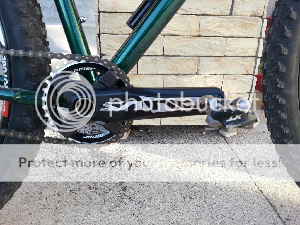

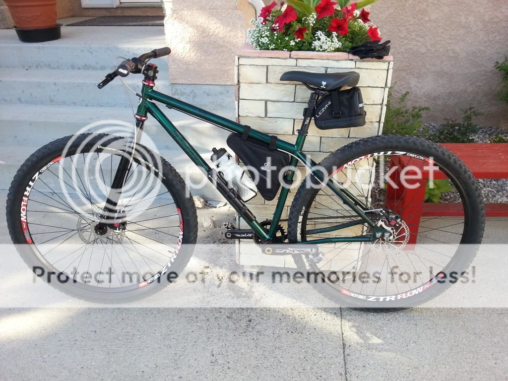

    I'm riding a TruVativ AKA (SRAM) crank and it is pretty awesome. I've been riding it since 320 pounds, now down to 265. It's a single speed setup so it sees lots of torque and doesn't miss a beat. It looks pretty darn good as well.
    It's also nice cause you can run it with three rings, two rings, one ring, or spiderless. So it's very versatile. I also have a SRAM X.9 crank that is pretty much identical. If anything, maybe slightly lighter but I've never weighed them to see. It's going on another bike. I haven't ridden it yet to tell if it's as good as the AKA or not but I'd suspect it is.
