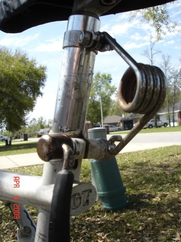

    i roll a hite rite... no weight limits... and being that it's worked for over 20 years... ;-)
    er ok... so realy I don't REALY use it... it just came on a '88 GT i bought recently
