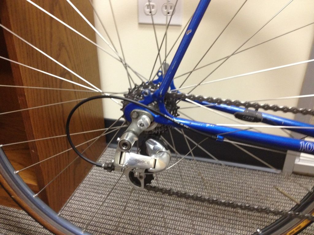

    I ended up with a used $80 1984 KHS Competition with a 68cm seat tube size. I stripped it, tossed all the original 10 speed (5 + 2) components, and rebuild it with a full Shimano Dura-Ace 9-speed STI group I picked up off craigslist used for $100.
    I then bought a new crankset, Sram apex 180mm compact double, which came with a new external bearing bottom bracket.
    Then for wheels I went with a Mavic Open Pro wheel w/Shimano Dura-Ace hub for the rear, with a Shimano Dura-Ace 9-speed cassette - picked up for ~$135 delivered off ebay used but in perfect shape - I think this wheel would work fine for your weight as it is regularly mentioned as being super strong.

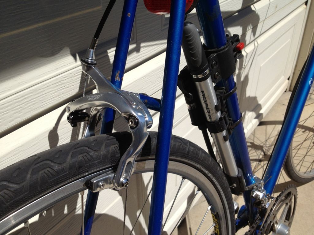

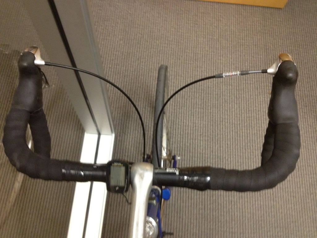

    I then added a set of Continental GP-4000s tires in 700x23 for the front, and michilen protek city tire in 700x35 for the rear for flat protection, some long reach brake calipers to help with adapting from the stock 27" wheels to the new 700c wheels, a new seatpost, some 3T ergo drop bars and new bar tape (original 1" quill stem reused), and a $10 factory take-off giant OEM road bike seat, and some commuter platform/spd pedals.

    How the cockpit looks now, the dura-ace group I picked up has the nifty gear indicator for the rear gears even -
    9-speed dura-ace rear full setup -
    this shot shots the special long-reach brake calipers I needed to work right on my frame to go from 27" wheels to 700c modern wheels -
