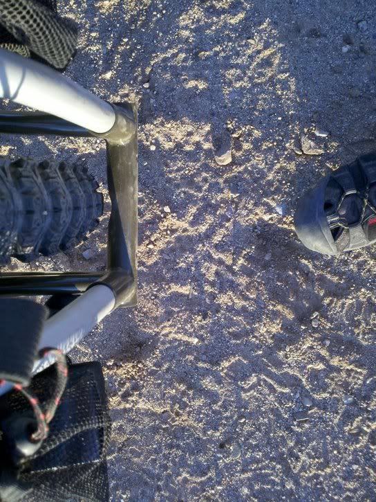

    If you go to extremes and use a hammer on the back end of the frame, you will be able to fit 26"x3.0" Duro Razorbacks mounted on 65mm wide Surly Large Marge Rims:
    Flickr: Jickmady Kulkarnisteakbacon's Photostream

    Quote Originally Posted by Leopold Porkstacker View Post
    I like what you did to your dummy. So much I did my own.
    <a href="http://smg.photobucket.com/albums/v136/Keener/big%20dummy/?action=view&amp;current=505114739_photobucket_577 98_.jpg" target="_blank"><img src="http://img.photobucket.com/albums/v136/Keener/big%20dummy/505114739_photobucket_57798_.jpg" border="0" alt="2011-01-01_17-02-39_346.jpg"></a>
    How ever backcountryeti was on about his Xtracycle and it is a wee bit different bit of kit.
    Were the dummy is a FFF winner between the two bikes side by side.
    The Xtracycle however might fit a taller tire then the dummy or so it would seem to me.

    Rhymes with fartmaster
    7,832
    Quote Originally Posted by Keener View Post
    Woops! There goes your warranty too!
    They ought have designed the Big Dummy to accommodate for 3.8" wide meats such as the Surly Endomorph, Surly Larry, Surly Nate, etc.
    Ouch that pic makes me a little sick poor BD I know that had to hurt a little.
