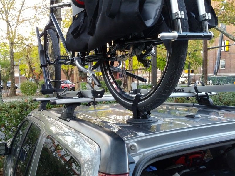

    While we're on the subject, when I picked up my BD, my LBS had that thingy installed as such:
    Is that correct? It looks like it isn't according to that second pic in this thread
    178
    You have it stored correctly. The pic above is how it would be used to fix the frame.
