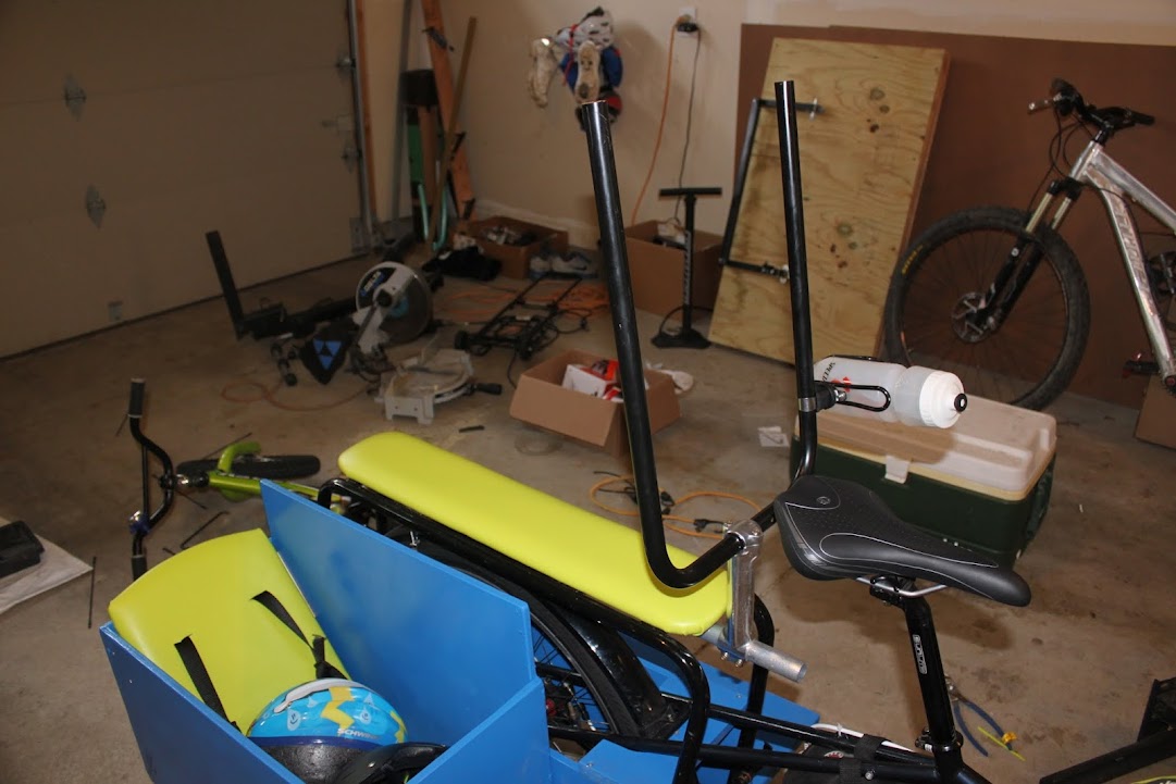

    Here is my setup, it is similar to your situation, although I do not yet have both kids on the back. I got a long stem off of ebay for $10, took the handle off of a fertilizer spreader, bolted a piece of 7/8 aluminum to the underside of my deck, connected em all up, leaving the "handlebar" connection just a bit loose so that it could pivot up and down. Still needs some finishing touches, wrap bar, cut off excess tube, paint, etc. but it is working very well so far. Next spring my little guy will be big enough to ride on the back with his big bro, I will probably extend the bar a bit further back and take the seat out of the side car and mount it to the deck. This will keep him from falling off the back and still allow me to belt him in. Given the age of your kids, you could probably just leave the back end open, or put a small board there just in case. Also, you have it easy as you just need to find the handlebar and can connect it into your seat post mounted stem.
    Lawn mowers, fertilizers, they have the perfect size bars for this.....

    That's the exact thing I was thinking of. Looks great. Are the bars very flexy as they extend back so far? Can your kids (or at least the big one) move the bars and get on and off by himself?

    Thanks.
    No, bars are not flexy, the only issue is that there is no stop for the bars, meaning you can just continue to push them down.
    Yes, my oldest (4) is able to operate the bars himself.
    I've been thinking a bit more about how I will set this up when both kids are on the deck. I for sure will have a vertical piece at the back of the deck and extend the bars all the way to it, likely having the bars rest on some type of other bar mounted to the seat back.
    Something like this, but at the very back of the deck, you'll have to use your imagination a bit.
