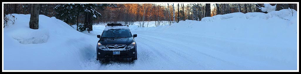

    BlackCanoeDog
    :) gotta love winter...
    Canada Edition 2013 DGM Crosstrek Sport MT
    WeatherTech Floor Mats
    Cargo Bay, Rear Seat Back, and Bumper protectors
    Splash & Mud Guards and 3M Clear Bra
    OEM Trailer Hitch / 7pin wire harness
    Yakima Rail Grabbers, bars, and Aero Winglet
    Yakima Big PowderHound ski racks
    Yakima Holdup hitch mount bike rack
    currently on Bridgestone Blizzak winter tires

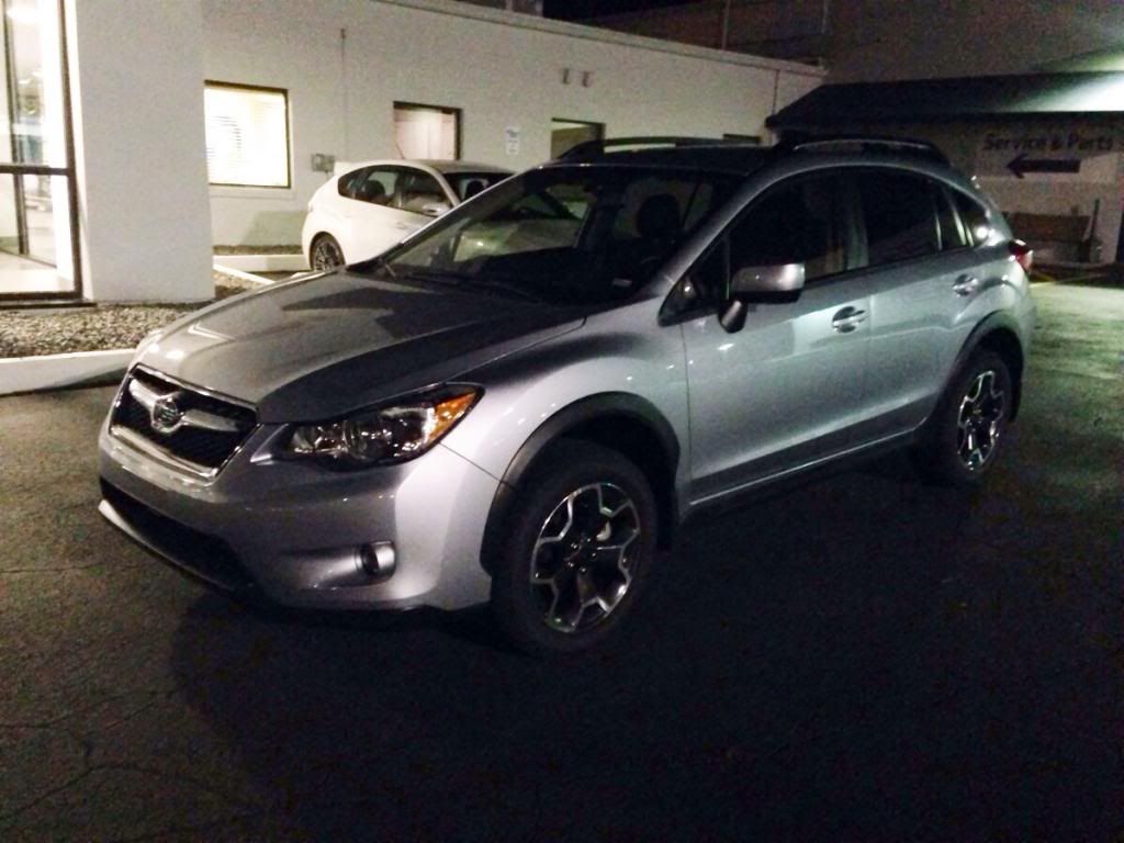

    ranier
    Yesterday, I drove home a '14 Premium with sunroof trading in my Honda Fit. My first foray into the Subaru world. The ride and driving experience as much better than the Fit. Got a great deal on my trade, got the car well below dealer cost and they even threw in rear spoiler.
    Now to decide on a trailer hitch and maybe darker tint on the front side windows. Pretty excited, my first new car since I bought my Frontier back in '99. I literally drove that til it died and plan to do the same with the Crosstrek!
  • 02-07-2014
    trek7100
    Congrats on the new purchase. Photos? Can't wait to hear your reviews on it. Subaru has been suggested to me, they're not real popular in my area tho. How did you decide on the Crosstrek? What about Forester, Outback, or Impreza? Did you get a MT or auto?

    Finally got my Crosstrek. What a nightmare experience... Don't think I'll ever buy new again but I think I did get a good deal. I ended up getting an Impreza Sport too. I think that made it all the worse in negotiations. Took twice as long. Don't ever buy two cars at once. I was in there for six hours. Well, I don't get the impreza until tomorrow but here is the Crosstrek in the dark. It is actually the wife's vehicle. She wanted one too and I didn't want to have two Crosstreks. I thought the Imprezza Sport Premium in the same color looked great so got it for myself. Is it cheaper and better to buy a roof bike rack 15% off from Subaru or buy online somewhere?
