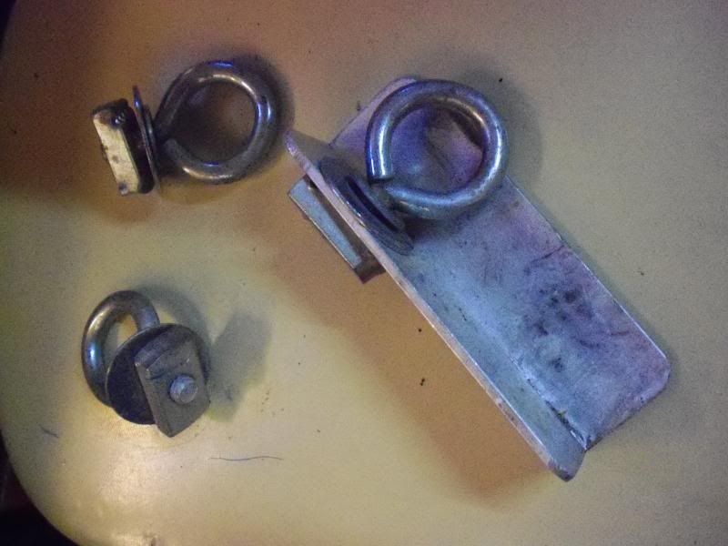

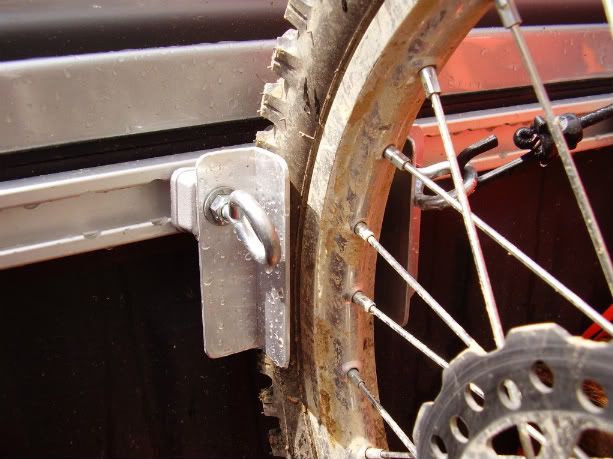

    I had a Frontier for 6 years. I fabbed a couple of tire-holders with the Uni-strut nuts and angle aluminum. Originally, pictured below, I used the factory stop blocks as stand-offs for the angle aluminum, but they got tossed in favor of the Unistrut nuts. Dirt bikes here, but the tire holders worked great for the MB. Using eye-bolts provides an additional tie-down point for other activities. Front tire in the holder, then a ratchet strap around the seat post and fastened to the side rails with the factory rail hooks (or you can use the floor track for one end of the strap, creating an "X" with the straps when two bikes are loaded).
    Here are the tire brackets and a couple of extra tie-down eyes (they're 3/8" x 16 thread pitch) for any part of the track. IIRC, there are a couple of different sizes of the Unistrut nuts. Different size threads in the middle and different thickness. I didn't need to file these down for use in the front and side rails, but I think they wouldn't fit in the floor rails. It was a lot of beers ago, so I'm not sure. All I did is snip the springs off the nuts, matched the thread to some eye-hooks, threw on some washers and off to the races.
    That Frontier factory rail system is about the best option ever. Very handy. I miss it.
