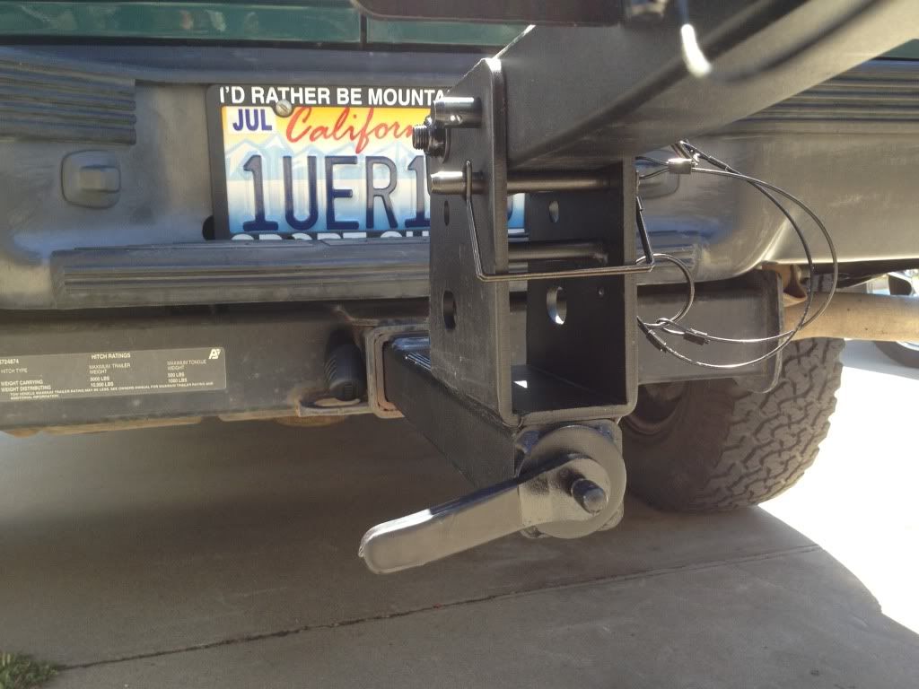

    The rack is so stable and secure because of this system pictured - It uses a standard hitch lock at the hitch, but there's a rod that the pin goes through in the middle which is grabbed by this crank pictured, once the pin is in you turn the crank to add tension to it and that's it, locked down tight solidly mounted to the truck!

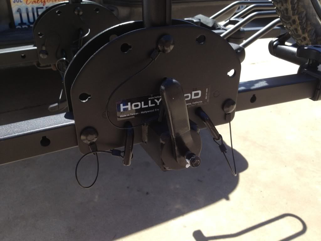

    The 4 bike add-on portion of the rack attached to the front 2 bike portion in a similar fashion with a hitch pin and tensioned rod on a crank so it too is very tight, I did notice this section does feel not quite as solid as the first 2 bike part, but still tight. Of note this portion inserts with what looks like a 1.5" hitch size as it's too small to put directly into a 2" hitch (I tried throwing this part on the hitch of my other truck and no dice, would have been cool to effectively get 2x 2 bike racks for $400 oh well)
