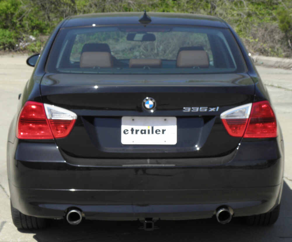

    The hitch would be visible from the rear. My car is silver so a black 1 1/4" hitch would definitely stand out. Here it is on a black 335i and it's still noticeable.
    It's not obnoxious, like you see on some of the redneck pickups in Atlanta, but it's noticeable and it's always there.

    Most of the time it improves it with a RWD car, usually there's slightly more weight on the front, especially with a gas tank that's less than full. That receiver can help to tie the rear together, and with the addition of a strut brace, you can significantly tighten up the handling. This without the bikes and just the receiver.
    Sure, you can't yank through the turns too hard, although I kind of still tried with my WRX, but you're going to rip the bikes off the top rack with the same kind of forces or bend stuff on the rack at the forces you'd start to encounter the real negatives of aggressive driving with bikes.
    Anyways, that receiver on that 335 looks good, you can barely notice it. Seriously, 99% of the people that will look at your car will never notice it.
