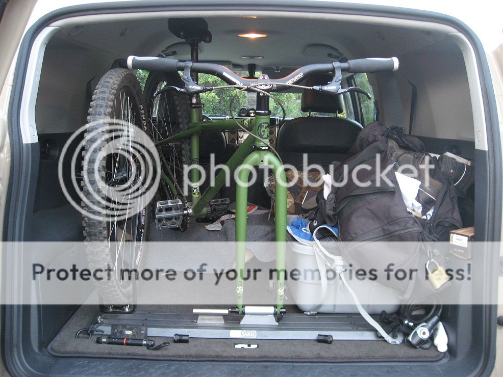

    Here ya go! First pic is the full kit, left to right 20mm, 15mm, and 9/10mm QR all components are steel and appear to be pretty good fit & finish. The 15mm fits my fork much better than the previous fork mount no real tendency to slip out and I can shim this one if needed. The QR is at least as good as the one on the Delta that I'll toss with the added bonus it's rubber coated and thicker. The parts are all knurled so changeout is real quick. Took it out to my FJ, pulled the Delta and put the Origin8 in next to my ebay mount, stands a bit taller about as high as the Delta, but RIP9 still fits. I sometimes put 2 bikes in so I will get another without hesitation. I have an IH 7p3 I could try the 20mm on but no QR there.
    RIP9 in place, this mount will go near where the Delta was in front of the ebay mount(laying to the left)
    Literally a 30 second changeout to get the GT in with QR
    I was running out of light so pic is blurry but closer to where it'll be (keep meaning to trim those cables)
    What product/part is holding your front wheel? Is the 4'wide aluminum base part of a system?
    thanks in advance, I am looking to do the same set up you are using (15mm fork)
    The wheel holder is a Saris brand for the Saris triple track rack I'm using, though it could be used for others, held in place by a couple of carriage bolts plus wing nuts and lock washers used to hold the mounts also. Scored the Saris stuff cheap off ebay, expensive on Amazon for what it is. My triple track is the 35" wide I believe but there's a 47" also.
    Amazon.com: Saris Wheel Holder for Saris Single or Triple Unique Mount Tracks: Sports & Outdoors
    For the 15mm hub on the RIP I use a set of Mavic adapters 15mm/QR adapters, to hold the wheel in with a QR skewer. Pull out the rubber O-ring and they slide in and out much easier
    Mavic 15mm to 9mm Q/R Adapter 2014 | Mavic | Brand | www.PricePoint.com
