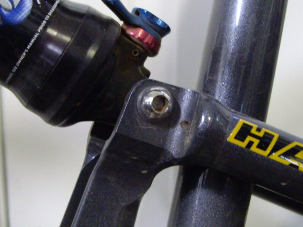

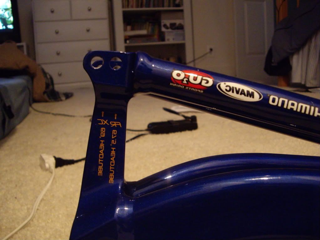

    Here are some pictures comparing my 12mm Thru axle swing arm to my friends Rush swingarm. I reversed one of the pictures so they are in the same orientation.
    Prophet:
    Rush:
    EDIT: Sorry the picture disappeared for a while. It's back now.

    i see the difference in the photo. the swing arm in the shop is the rush one based on the pics and from what i have been reading. I will talk to cannondale in the morning and see what they can do about my prophet. I wonder if i flip my stem to a neg angle and get a flat bar if i can offset the slacker angle??? or if i lower my front end some how. i climb a lot with my prophet and have had to replace all the stock parts. All of them to make her ride the way i like. I hope this swing arm will not mess her up.
