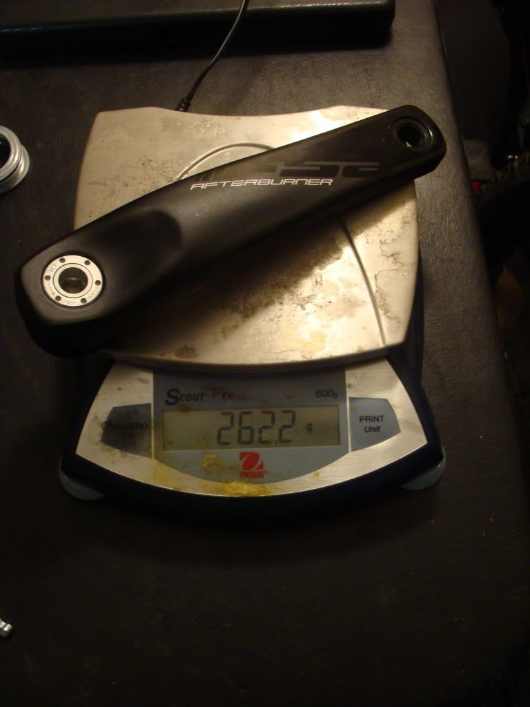

    One came stock on my 29er, I took it off in favor of a Hollowgram with XX rings.
    I rode it a few times before taking it off. It was solid, nice and stiff. BB30 plus the super wide arms made a really stiff and responsive crank. It isnt the lightest crank out there, but at 812g without bearings its respectable.
    Drive side:
    Non-Drive Arm:
    Just noticed I left the der. height sticker on for the first ride.

    Quote Originally Posted by amillmtb
