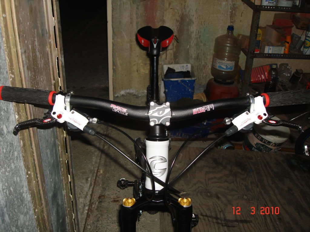

    Freerider you have to factor in several things. The prophet was designed with a 1.5 to accept the Lefty fork. This doesn't mean that you are obligated to install that specific fork, it does however mean that you must compensate for the differences. You must leave enough space in between the crown of the fork and the bottom of the headtube for the rear brake line as well as the shifter cable. See my setup below:
    Now keep in mind that I have not done this as I have used the FSA reducer cups/inserts. They have not left enough spacing and the clearance is tight. Due to the design of the fork I am using there is no where for me to do the double zip-tie cable holder trick (well actually there is but I think it will look terrible). This means that at some point aside from damaging my paint I will be damaging the cables/lines as well. I cannot tell you how long my steer tube is on my fork as it was about 8 before the install and I don't know if my LBS cut it down.
    My advice is not to rush into buying a fork that you will regret later. It is always better to have more steer tube than you need than not to have enough. This will also change the height of your handlebars if you want to raise them.

    Yes that is an FSA reducer cup. I got it off a friend of mine that wasn't using it, so I don't know where it was purchased. If you look closely at the first picture, you will notice that the bike shop that built up my bike added 2 spacers above the reducer. The first one being tapered and the second just a straight (cylindrical) spacer.
