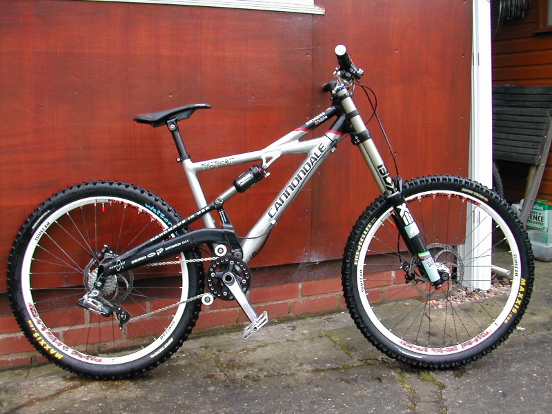

    Do it. It will transform your prophet from a twitchy nervous endo waiting to happen into the true all mountain light freeride beast it was meant to be.

    Had heard so much about prophetís turning into great freeride ridesÖ
    wow nice ride nankerphelge
    What fork suspension is that and how does it ride?
    Really stocked about doing the transformation
    The bike that i saw running on the 180mm domain looked a lot like the one above. It looks like its ready to rumble! Nice one man.
    What type of forks do you have on nankerphelge?
    Gravity's Gone
    Reputation: nankerphelge's Avatar
    1,384
    It's a Manitou Sherman. It's a 170 mm fork that came stock on quite a few Geminis so it's perfect for the task. As wyatt said I've been running it for two years with no issues. I even used it for bikeparks & shuttles until I got a Perp. I'll try to find some pix of our buddies with the Domain. Even though the Domain has 10 mm more travel the Sherman rakes the bike out more because it's such a tall fork. I've run mine in both fr & xc modes with no probems although I prefer to run it in xc mode since it's been relegated to everyday trailbike duty. DISCLAIMER: You will exceed Cannondale's maximum axle to crown length. Not only will you void your warranty, but some people would even consider this dangerous. That being said, what do I care? I also run an eight inch rotor on the rear which Cannondale says you can't do either. Look at the second front triangle where Cannondale welds the small tube from the toptube to the headtube, That makes the headtube so strong I don't there will ever be any worries. Good Luck.

    170mm fork on a normal Prophet in the XC head angle position? Looks cool, and not to dis, but is your BB height approaching circus bike status?
    I just wanna go fast!
    Reputation: bdamschen's Avatar
    1,771
    I've had a few different forks on mine and beat on it pretty hard.
    For "freeride" or "light dh" or whatever, I found a 160 mm for about as tall as I'd want to go.
    I've rocked a Magura wotan, RS Lyrik, Revelation, the original lefty and a 36 float. The 36 Float so far has been my favorite. Even when hitting big jumps/drops or rough sections though, I like the way the bike feels with the fork set at ~140mm, that goes for the float too.
    If you go with something like a domain or totem, I would modify the internals (totally doable) to 160 mm max, maybe even lower if you can.
    Oh yeah- and just because some dude put a dual crown for on a prophet doesn't mean it was a good idea. These frames were never designed to have that much stress put on the head tube. You're safer going big on a 140 mm fork that won't cause your frame to break when you land than with a boxxer or full length totem up front, guaranteed.

    I can't find a whole lot of good shots of the Domain.

    It's 180 straight off of a Perp. He rocks an extra small (petite) frame, too.

    Quote Originally Posted by cannondale-tim
    This little Prophet will handle most of the stuff I hit on my Judge. 180 mm Marzoch up front and a 2.25 stroked DHX in the rear.
    http://picasaweb.google.com/cannonda...61436386825410

    Here's mine, with what I believe a perfect setup for trail and freeriding here in the Alpes ; Domain Coil U-turn 115-160 mm, it handles the bikeparks and most of the downhill courses around here. If you compare it with the stock Lefty there is almost no difference in the axle-to-crown hight. Only the rearshock needs a replacement, its 10 mm shorter e2e (Marzo Roco TST-R 1900 mm) and I want to replace it with a 2,25" travel setup to match it with the front.
    My setup for 2010:
    Prophet MX2 size medium [2006]
    RS Domain 318 IS U-turn 115-160 mm
    Marzo Roco TST-R (probably replace it with a DHX 4 or 5)
    X9 with DRS chainguide
    Avid Juicy sevens with 200 mm rotors (oganic pads frontside and sinterd at the rear)
    Schwalbe Big Betty 2.4 or Schwalbe Fat Albert 2.4
    Gravity-dropper seat-post 4"
