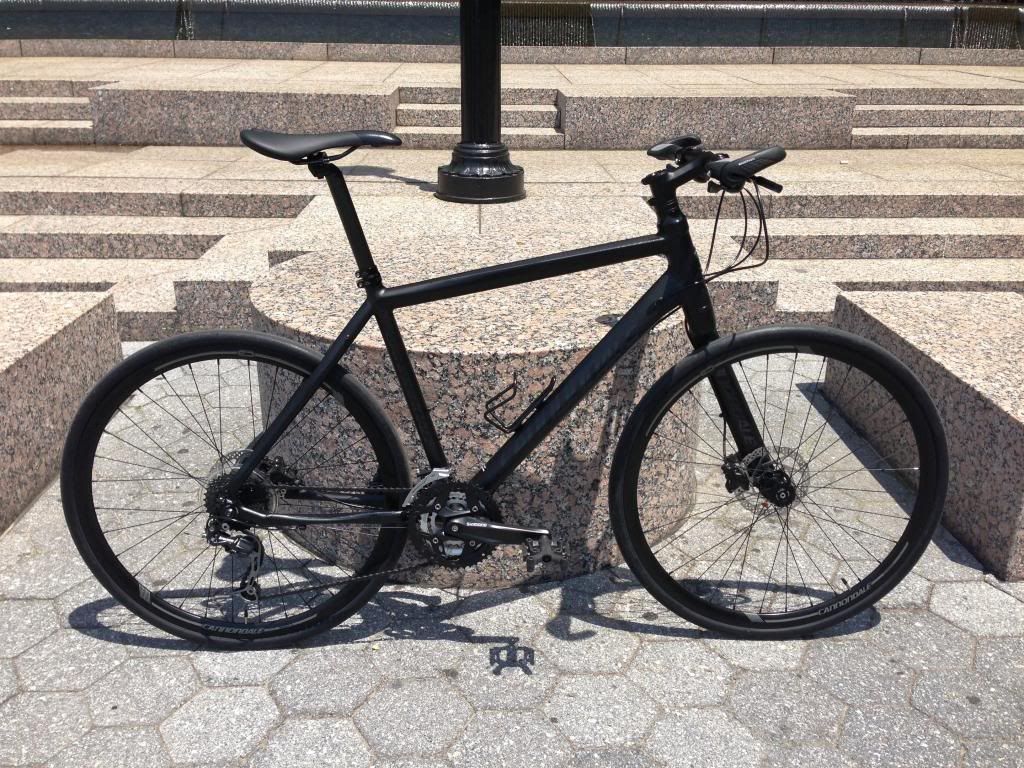

    Quote Originally Posted by xlerate View Post
    First Post here.
    I'm from Westchester, NY... just outside the city.
    Sold off my Cannondale Trail SL4 for a 2013 Bad Boy 5.
    I'd like to change out the tires for something with a bit of tread as the Kojak's are not very confidence inspiring.
    Also, need to change out the hand grips, as my palms take a beating, maybe something with some horns.
    Any suggestions on the tires & grips? (also, don't want to spend too much, but I'm not into getting something that's cheap to just be a waste.)
    Attachment 809450
    marathon supreme or contact 2?

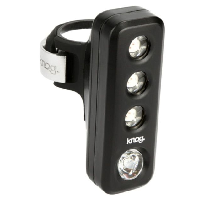

    picked up a knog blinder r lastnight, man this this was made for the bad boy! looks awesome, and embarrassingly bright! lol
