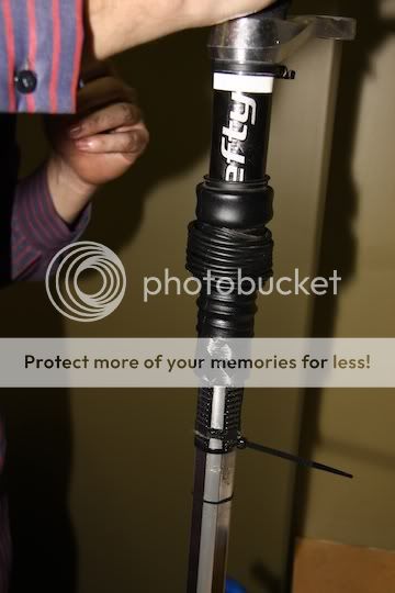

    fredde_nu
    Hi!
    I need to change the boot on a Lefty Speed 110, does anyone have a DIY guide? Or some instructions of how I split the fork? Thanks!
    /Fredde
  • 10-01-2010
    MendonCycleSmith
    Originally Posted by fredde_nu
    Hi!
    /Fredde
    Don't pull it apart....
    Wrap the axle well with duct tape, covering the sharp disc tabs well. Might even put some foam over them prior to the tape. Wrap it down tight.
    Grease the crap out of the tape, and carefully slide the boot over. It stretches nicely, so with slow steady work, it should go without issue. :thumbsup:
  • 10-01-2010
    fredde_nu
    Ohh thanks! I tried that in my first attempt but broke the new boot. Didnt duct the tabs so I will duct my best and give it a new try! Thanks! :)
    /Fredde

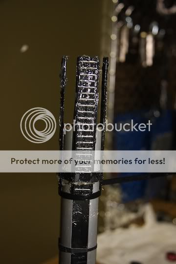

    BlownCivic
    Help please! I am in the middle of rebuilding my 2009 Lefty Speed Carbon SL OPI SoloAir (wow, that's a mouthfull!). The damper cap (white plastic cap) came unscrewed somehow, and puked the oil all over the inside of the boot, effectively washing all the lube off the bearings. I caught it quick enough that there is no damage.
    However, I am struggling with putting the upper/lower back together. My inner bearing race setup appears to be very different from the photos shown here. There is a captive washer type arrangement at the top of the inner races, similar to that found at the bottom of the outer races, and this is preventing me from being able to "slide" the bearings/inner leg into the outer.
    There's a lip on the captive washer that will damage or foul the bearing as I try and slide it together. I cannot install that washer after the upper/lower are mated, as it would be much too far down inside the leg cavity for me to reach.
    I can't perform these 3 steps:
    because of this:
    What do I do?
    Thanks.
  • 05-04-2011
    BlownCivic
    OK, I found out on my own. Brandon at Cannondale talked me through it. I have to put this puppy together without the retainer, and then fish the damned thing into place 6" down inside the outer.
    Wish me luck!
