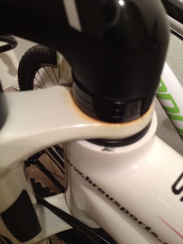

    Reputation: wallstreet's Avatar
    347
    Lefty xlr on hi-mod2 Flash, photo what's this stain?
    My hi-mod 2011 has this staining around the fork, would you say this is oil? I can't get it off.
    The bike rides perfect, one guy I know is sponsored and rides these bikes but said he has never serviced his forks in 5 years??? He rides more than me. I do 500km a year only.
    Thanks in advance
    Edit:- I wrote to Cannondale, they replied within 36hrs (impressive) it will be checked on by a dealer & reported back to them. It's rare. A member has already stated that it may be oil staining this area. I plan to change the OPI anyway so I shall hope to get it cleaned up.

    Nov 2004
    659
    Quote Originally Posted by IowaBadBoy View Post
    Hello
    I recently purchased a used Bad Boy Disc Solo.
    I'm concerned that I might be missing a spindle or something on the front fork/wheel. On the riders right side of the bike theres a allen screw and on the left side of the fork theres a threaded hole. I can see all the way in this hole.
    Should there be a spindle or is the allen screw on the right side all that holes the wheel to the fork? Hope that makes sense? See pictures below.
    Thank you!
    Nope, you are all good to go. The allen bolt on the non disc side threads into a spindle that is part of the fork.

    Big disappointment, new Lefty Carbon XLR 100
    Hello everybody
    Finally got the chance to hop on my new Scalpel 1 29er. After a few miles I had to interrupt the ride because the fork was not performing anymore. I found out that within minutes, the fork had "travelled down" and now rested at the very bottom point. When I dragged the bike up, the fork (very slowly) came back into the initial position. Since the bike comes with a remote lockout, I tried it locked too but the same thing happened. I tried to work with the rebound whhel for some time, but it didn't make much of a difference. The pressure is fine at 11.4 bar.
    Fork: NEW LEFTY CARBON XLR 100 29, HYBRID NEEDLE BEARING TECHNOLOGY
    Any ideas?
    Thanks and bye.
  93. #293
    119
    Exactly the same thing that keeps hapenning to me. I think it's a transfert of air pressure between positive and negative air chambers. But if someone can give us THE cure for this phenomena... he will have a great thanks from both of us !!!
  94. #294
