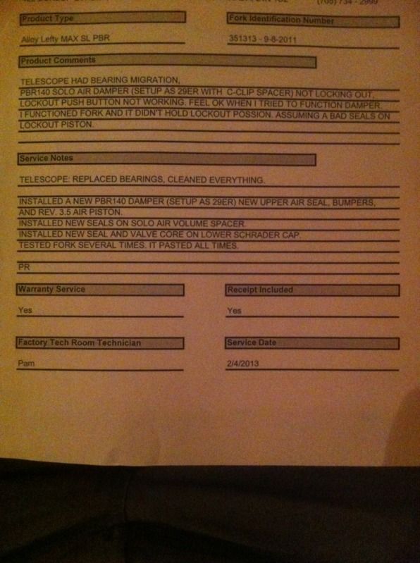

    Accordin to the paper work, everything was replaced. Damper , all solo air seals, bearings ect. Im suprised it klunks the same way. When new the lock out was solid with no play. I dont know what to do now. I love this bike but out of my 8 month seao. Its been down for almost 4 months. Not to mention my warranty is up next month.

    It said they replaced the needle bearings, but if it they migrate too quickly they need to be re shimmer for proper re-load. Play when locked out means air in the oil, but since your rebound setting has no effect it seems something else is wrong as well. Do a forum search as several folks had similar rebound issues and it had to do with a setting on the lock out button.

    I just got it back yesterday after 2 months. It boggles my mind that the list clearly states that the damper is new. How can they give me 2 dampers in a row that have the same problem.

    I picked up the fork yesterday, installed it last night. Locked it out, notices the same dull thud and slight travel. Worried history was repeating itself, I then tried to cycle the fork and turn rebound and it makes no difference.
    As in the picture it appears to be a complete rebuild.
    I wish I marked the damper to male sure it was actually changed.
