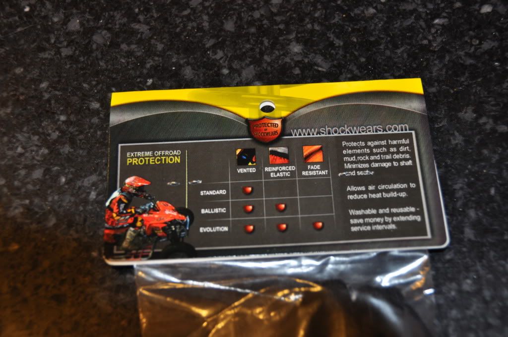

    The following pictures show the packaging, weight, and measurements when flat.
