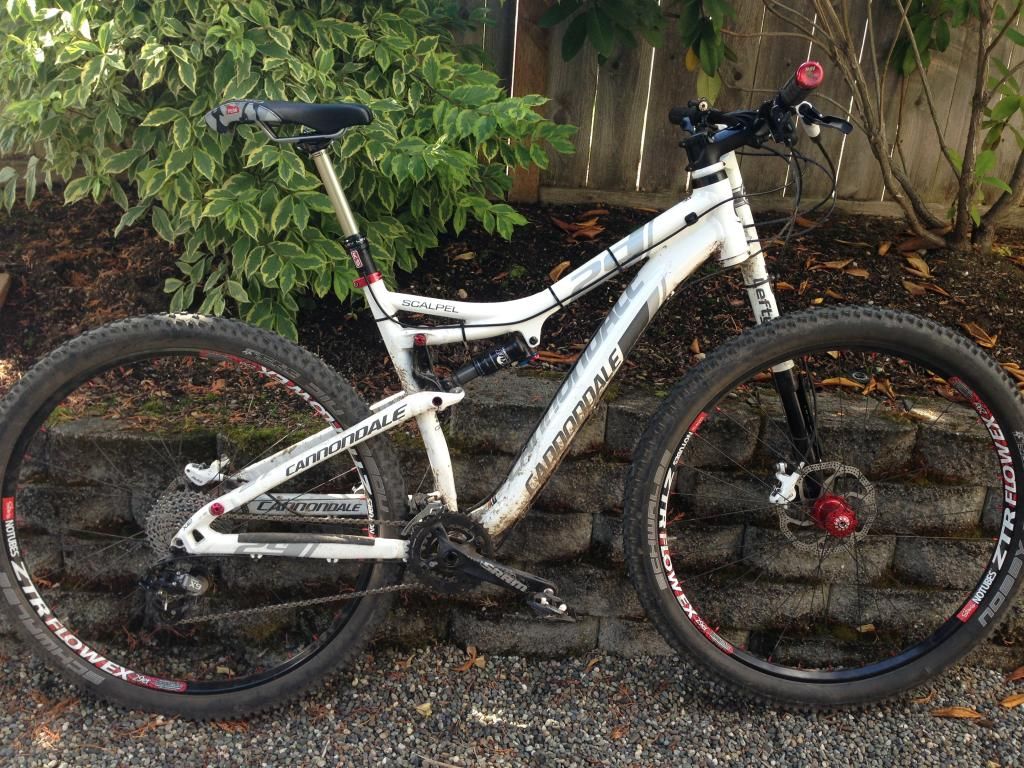

    Here's my Size L scalpel 3 with the top of the saddle at about 31.5". The post is a KS LEV with 150mm travel.
    Also, while it's not for the reverb, there's a thread on the KS LEV that will get you into the ballpark. The LEV and Reverb seem to have pretty similar designs to this should give you some idea. KS Lev sizing
