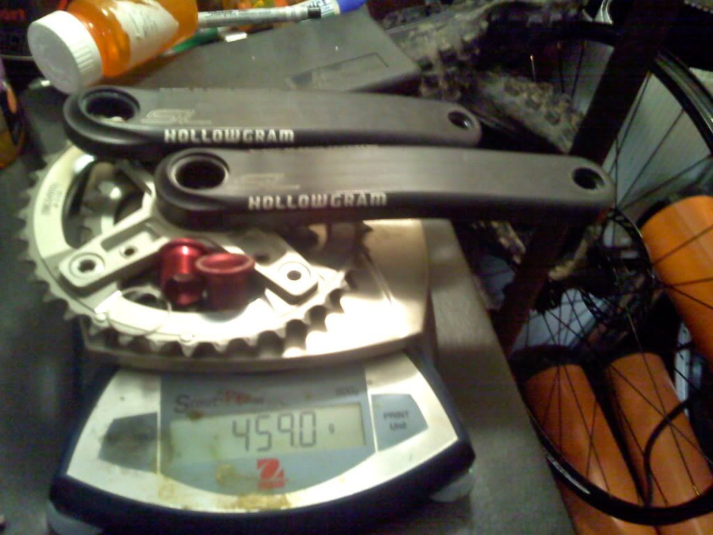

    If you can swing it for hollowgrams, do it. I am actually picking up my second set for the 'cross bike tomorrow. They are pricey, but the best money I have spent on my Flash. They are super light and very customizable, as someone stated with XX, X.0, or a triple.
    Speaking on behalf of the XX chainrings, I have not seen much wear that I would consider to be out of the ordinary. I am running them with a KMC x9SL (yes, 9 speed drivetrain...I love my twist shifters...don't hate).
    Speaking on behalf of the weight, 'Nuff said...
    (I know...shitty cell phone pic, sorry.)
    There are more photos in the album in my signature breaking down the overall weight of all of the parts of the crank.
    To pick from any of the other options, I would say to go with a Sram product. IMO the chainring options are much better.

    Amillmtb: ok, that pic is quite convincing!
    After all the advice here I'm going to try my damndest to get hold of some Hollowgrams one way or another. Besides the low weight (which may well turn out to be the deciding factor in me getting my Flash under 20lbs) the flexibility of the spider etc. is awesome. I agree, it does make sense to make use of the excellent BB30 stiffness, rather than put an adapter and smaller axle in there.
