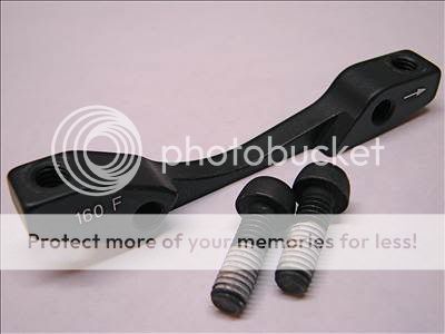

    Oh well, allready thrown more money at this than I paid for the bike, but it's all a learning experience so it's worth it
    "Avid Post Mount to IS Front Disc Brake Adapter 6"/160mm"
    Would that be the adapter I need?
    Mar 2005
    115
    that should be the one
