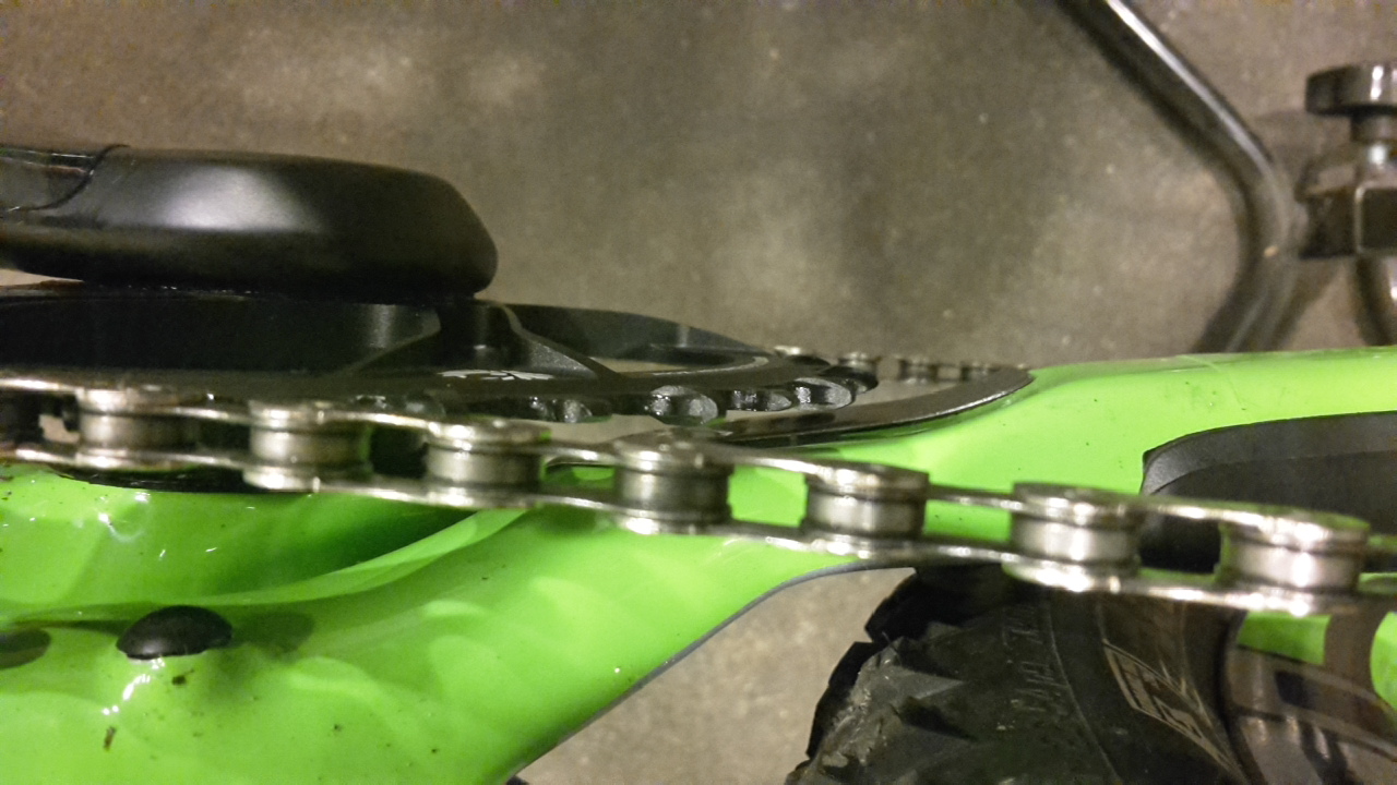

    Jan 2018
    2017 Scalpel Count-Down-20171231_224423.jpgName:  Cannondale Forum.jpg
    Could someone please upload a photo or two of their upper shock mounts in their frame. Seems to me i'm missing some carbon around my bushings.
  30. #730
    174
