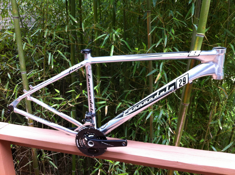

    I've recently purchased a used 2010 Flash 1 29er aluminum frame and it's in very good condition. The money I put aside for a brand new bike will go towards this project. Any suggestions will be aappreciated. Here's the build up plan:
    1. Replace all bearings
    2. SRAM XX1 (cassette, crank, chain, et al)
    3. Shimano XTR hydraulic brakes and discs
    4. Stan's ZTR Flow EX rims (I was thinking of Mavic Crossmax too)
    5. PRB Alloy Lefty
    6. SAVE seatpost
    Not sure about the handlebar yet as I want non-painted aluminum to match the frame. Perhaps a Chromag silver bar.
    For petals I'm using my Speedplays from my GT.
    Here's a snap shot of the frame (it actually did not come with gears and crank):
    My LBS is doing the build. One thing I'm concerned about is getting parts that can only be used on this frame -- but I think all of these parts can be put on another frame if I crack or damage this one.
    Thanks in advance for your input.
