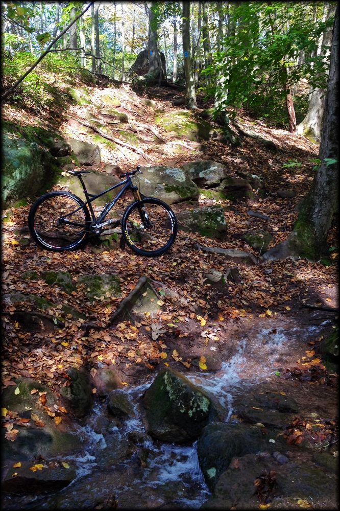

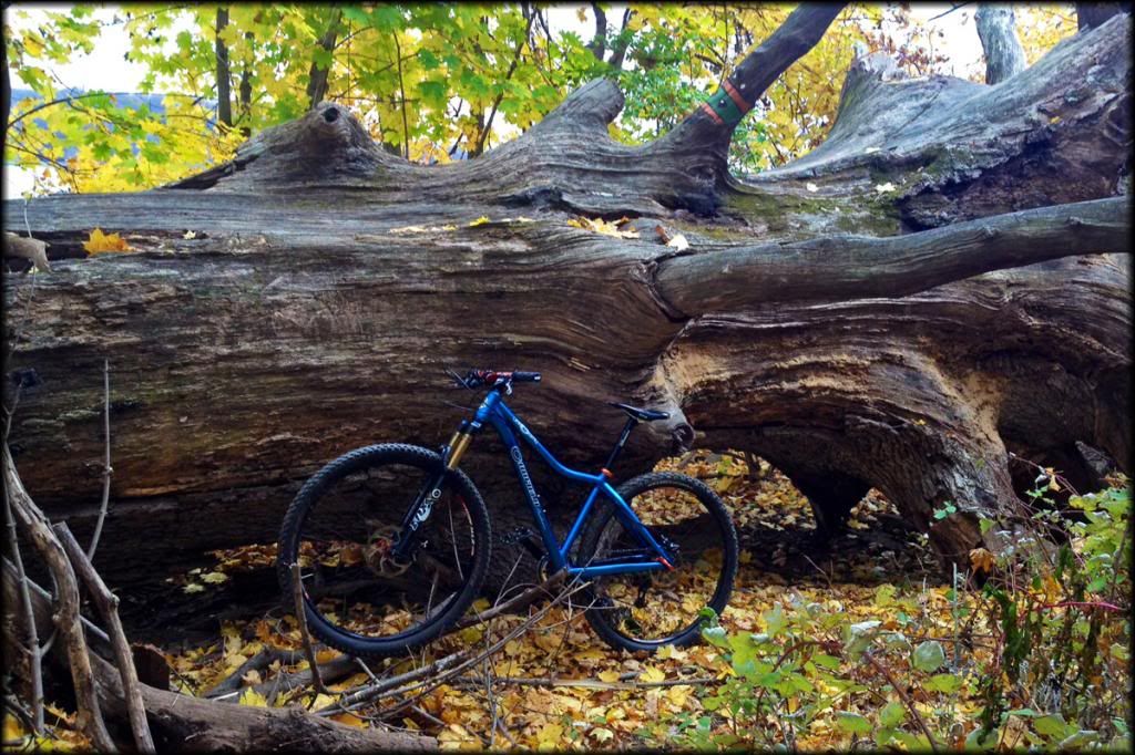

    And some photos of each build:
    Nimble 9:
    YelliScreamy:

    Finally got some pics of my Canfield Bros side by side. Pardon the ice-storm damaged willow tree in the bg.
    First race of the season this weekend... it's an endurance race so I'll be riding BOTH of them in it since I couldn't decide.
    God I love these bikes.

    BTW- Last night I finally got the Nimble 9 out again. Damn that bike is fun too, just a different kind of fun than the Yelli. I'm sure a lot of it is 70mm stem on N9 vs. 50mm stem on Yelli, and 100mm travel on N9 vs 140 on Yelli. But wow.
    I love the steel. And the shorter travel and resulting slightly steeper HTA makes this bike very, well, Nimble. And quick.
    Managed just under 10 miles with 1,000 feet of up before we ran out of light. I left with a huge smile on my face like always.
    I've usually always kept 2 mountain bikes. A single speed and an XC or Trail bike. Lately I've been wanting to build a FS in either 26 or 27.5. Every time a new build has happened in the past, one of my current bikes hit the chopping block. This is the first time that won't happen. Just gonna have to save up for the FS bike because neither of these are going anywhere.
