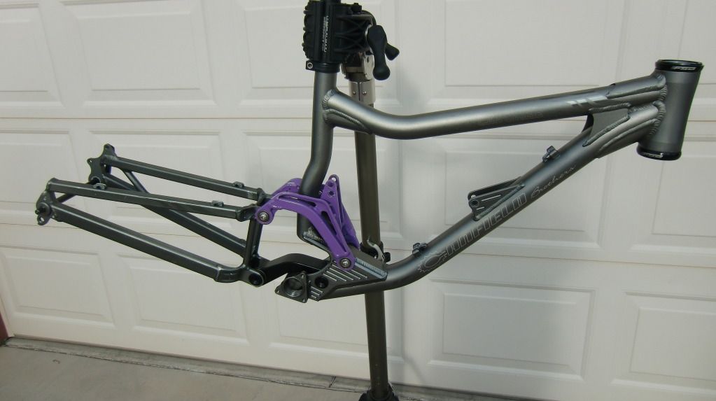

    Hi everyone, I just bought my first "big" bike and was hoping for some advice on building her up. She is Wiggle, the Can-Diggle (S) and the rear shock is a CCDB. This is what I have to start with. I will be using her for steep, rocky, some drops, technical, turny (sometimes fast) downhills....and I like to jump. (not big, yet!) I plan to mostly shuttle or ride a lift but being able to pedal occasionally is a plus. I have 20 yrs of dirt bike riding experience on trails, and 1.5 yrs on MTB's. My current ride is a 6inch, lightweight Giant Reign. I live in N. AZ so I ride Sedona, Flagstaff, and Phx. Traveling to Bootleg and Angle Fire are most likely in my future. I am old and weigh 143 w/out gear. Here is a pic to break up this long post.
    Here is where I need help:
    1. Fork....I want a single crown 180 coil.....but I am open to change if this is not the best option for me. I want a fork that is active under braking and has minimal brake dive....Used or NOS is ok as I am not wealthy. (1.5 steerer as I don't need an angleset)
    2. Crankset....I need 165mm arms, want to go 1x9, need some kind of bash guard (lots of logs, not to mention rocks). Not sure about wether to go chainguide/taco bash or bashwich. I can go used or NOS here as well.
    3. Brakes....4 piston or 2 piston? I ride 2 piston with 180 rotors on metallic pads right now, and feel like I want a little more for the really scary stuff. (or maybe I just need to go faster?)
    I know many of you out there have a ton of experience with these bikes and different set-ups, and I would love to hear anything you have to say about my build. Please ask questions if you need more info. I will X-post in DH/FR as well. Thanks in advance.

    Very nice Brenda! I like the purple
    Reputation: Joules's Avatar
    3,159
    1: I'd go with a totem, be aware that straight 1.5 forks are getting rare. Not that it matters... 36-180 and marz 66 are the other options. I've been really happy with performance, ease or service and tuning options on rock shox products. I think Marz products across the board are a little pricy, considering they, as a company, are in a kind of "rebuilding trust" situation.
    2: My favorite crank ever, SLX doesn't appear to come in 165. XT does. I'd just get a triple and whatever bash ring you like. IMO there's no need or point in looking anywhere but shimano for cranks. I like the bashwitch setup, but I'm sure there are merits to guides.
    3: brakes are more than just the number of pots. I have Magura louise 203f, 180r on my One, unless you have really unusual needs, I wouldn't hesitate to recommend them. I weigh considerably more than you (like 80 freaking pounds...) and never had a problem with power. Louise works, doesn't complain or require much maintenance, has the easiest and least messy bleed I've ever used (and even that's a once every 3-4 years kind of task), and are surprisingly moderately priced.
    That Diggle looks beefy. I miss the oddball-colored links...

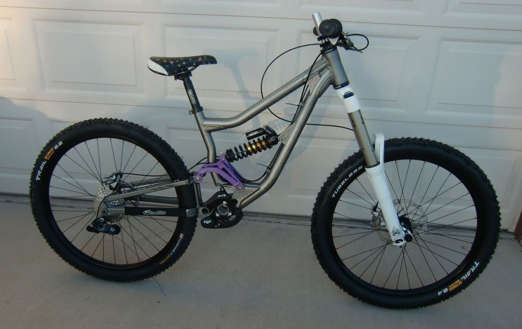

    Hubby gave the green light to spend away and pay for it later! Plus I am selling a bunch of my vintage road stuff on ebay, it is making some good $$ so far. Here is where I am at today:

    So, 2.4 Trail Kings do NOT work in the rear, they are too tall. 2.2's do work, although they look tiny. Got the tires, rotors, cass, mounted...rear caliper mounted, shifter and grips are on the bars. Should have a stem and bearings tomorrow. I am getting super excited, I can hardly sleep.

    OK, here is where I was at, right as the sun was going down.....Gettin' there!

    Good looking frame. If you don't already, your going to like those Trail Kings. They pack some good performance. I really like 'em, though I found that the side walls a little thin for me as a 200lb rider. The side walls blew out a lot quick than the tread.

    I've been riding the 2.2's on my trail bike, and they work great for AZ. I pick good lines and don't just "bomb" stuff, so I usually run out the tread first. Knock on wood, no sidewall probs for me yet.
    I got the lines all trimmed, brakes bled and working so far, gonna cut the steer tube and get some much needed sleep! Pics tomorrow with my trail bike cranks on it. Any guesses on weight?

    Those are borrowed cranks I jerry-rigged on the MRP guide. So far so good!
    1,196
    by "jerry-rigged on MRP guide" do you mean you intentionally did not route the chain over the roller on the bottom? Good to see new this built, I have just been lurking to date and watching the progress.

    I couldn't run it thru the roller cuz these cranks have a triple spider and the bolt tabs hit the guide...had to take it off for the time being. I also had to space it out to get it to sort of run in the "middle" ring position. I have about 3 useable gears. The final cranks will be black Middleburns 165, with a single 28t. Should be here Friday.
    I got to do a solo first ride today. My hubby dropped me off at the top of the mountain behind our house, and then he picked me up at the bottom. I hit a small gap jump at the top, serious consequences if I failed! No biggie, bike just floated over it. It is more flickable and easy to jump then I would have thought. This was my first time ever on a "slack" bike. Hubby snapped a few pics of me at the bottom.....then we went to the movies.
