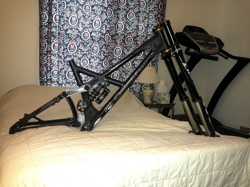

    So I just finished getting my bike build up on Monday. Most parts are either used or carry-over parts, but I'm stoked about getting out and riding/racing it this weekend.
    Some details on my build...
    - 2010 Large Canfield Jedi w/ Fox DHX RC4
    - 2011 Manitou Dorado Pro (2012 graphics and guards)
    - Mavic EX721/EX823 (F/R) laced to Hope Pro2 hubs w/ DT Competition spokes
    - Maxxis Minion DHF's F&R (running tubeless with Stans)
    - Avid Elixir R brakes (203mm F&R)
    - Shimano Saint M815 Cranks w/ Raceface DH BB
    - SRAM X9 Shifter/Derailleur and PC-971 chain
    - Dura-Ace 11-23 9spd cassette
    - Wellgo MG-1 Pedals (Getting a set of red Crampon Ultimates when they arrive)
    - Crank Brothers Opium Headseat (Dorado steerer tube was cut to short for traditional headset)
    - Sunline 42mm Directmount stem and old Hussefelt bars w/ ODI Ruffian grips
    - SDG Ti-Fly saddle on Thompson setback seatpost
    Final weight: 38.6lbs
    I'm probably going to change the rear shock to either a Marzocchi Roco Air WC or a X-Fusion Vector Air, the brakes, bars, and of course pedals later this summer.
    Due to a ton of rain around here I won't be able to go baseline it at the local trails before racing it this weekend. Any advice on how best to initally setup my RC4?
    And Pictures...
    Day I got the fork in....
    Complete (picture is a bit dark)
    Dark again
    Canfield Jedi, Canfield Balance, Canfield DJ, Cotic Soul
    Canfield Brothers
