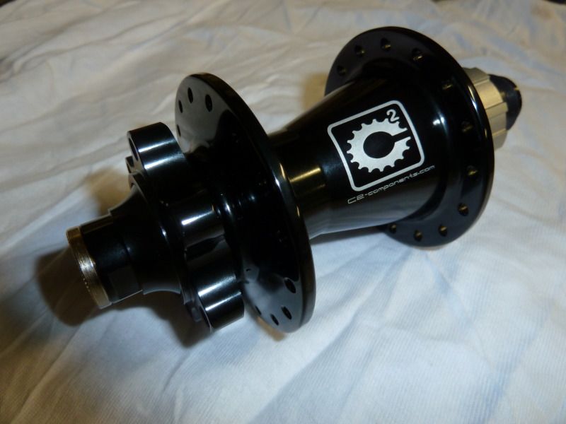

    Whats happened to the 9t 10sp package? Not on the Canfield site anymore and cant see anything on the blog...

    Ah Kool, cheers dude, that's good to know... Reading about the 9t 10sp it's sounds perfect for the yelli with a 30t up front.
    Running 11-36 & 30 on current bike and could do with a little more top end but don't want to loose the climbing gear

    Yes, that was exactly my intention. My set up is a 9-38 with a 29 (and 20 granny) front. I'm getting the same range as when I used my 13-38 9 speed and 20, 29, 42 front.

    9-38..
    is that supposed to be 9-36? I don't know of any compatible cassettes with a 38t, I thought 36 was the largest production.
    I, too, have a 9t hub and would hate to see it go bye-bye. I LOVE the range I get with it and refuse to put a front der back on!
    On a side note I just installed a mid cage der and the WTC 42t. I have a range of 9-42, but I can tell it doesn't shift very well already. Chain length is good and all the adjustments are solid, but it has a hard time getting up the large gap in the middle and then going back down it has a hard time not skipping a gear. We'll see how it works on the trails this weekend..
  9. #209
    Reputation: gmats's Avatar
    Apr 2005
    2,868
    Quote Originally Posted by TheRage43 View Post
    9-38..
    Yes, really 9-38.
    I dissected an SLX 11-34 cassette, added a 38 tooth Ti Action Tec cog on the end and that's what I put together.
    I outlined it with this post:
    My Version of a 2x10
    I am going to experiment with this:
    Cassette Adapter 28-40
    The situation is with the 27.5 wheels it's about a gear higher (harder) than with the 26" wheels. The 40 might put it right about right.
