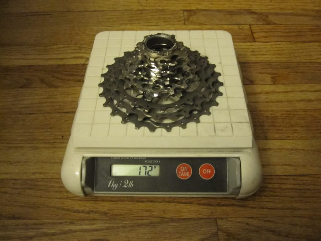

    Recon 9t Microdrive Cassettes
    We now are able to source full 9-36t cassettes through a company named Recon. They specialize in lightweight, beautifully cnc'd cassettes and now offer 9t cassettes. The 9-36t comes in at a svelte 191g! The cassettes retail for $159, however we are running a sale on our packages to help our customers convert over to a 1x drivetrain.
    To learn more, please see our webstore:
    10 Speed 9t Microdrive Cassette Package

    That's an awesome addition to your component lineup! And it weighs less than all but one of Sram's high end cassette which is only 6g's less! Great job guys!

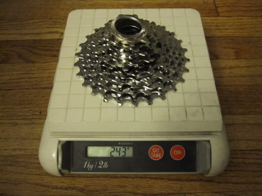

    Nice find Vin! Looks like the entire cassette is milled out of one piece, looks like a piece of art more than a cassette...

    Quote Originally Posted by TheRage43 View Post
    the NSB and wolftooth will both match up to the SRAM cranks in a 26t. From what I can read the E13 system only jives with its own guide ring
    E13 and Raceface seem to be the only ones doing their own interface. Everyone else has adopted the Sram interface which is really going to help with more compatible components to this in the, hopefully near future.
