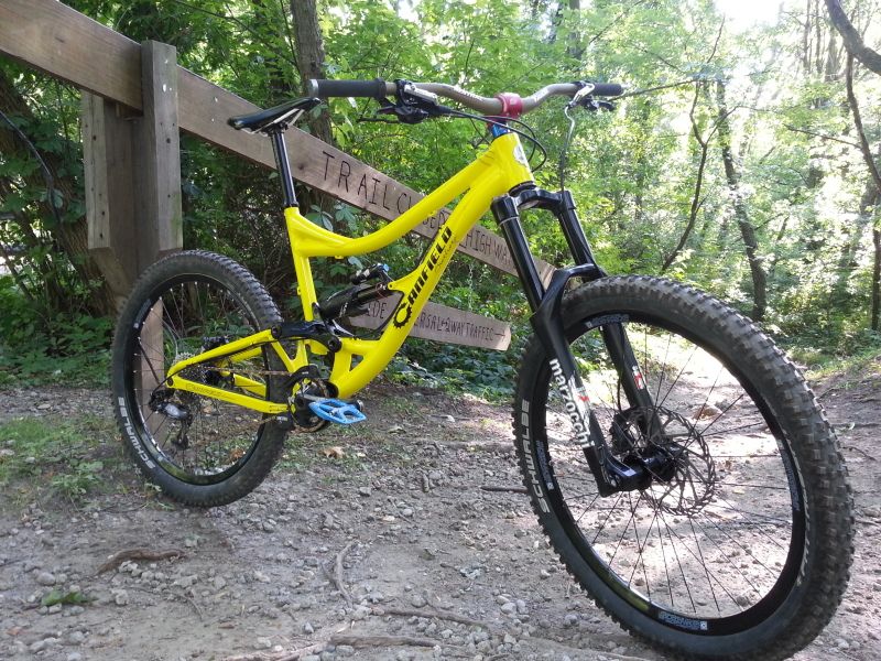

    Lightest "One" builds-2013-07-24-13.07.57.jpgLightest "One" builds-2013-07-24-13.08.07.jpgLightest "One" builds-2013-07-24-13.08.18.jpgI got my one down to 32 lbs, with some pretty tough components, as I break bikes and parts a lot.
    My ONE now weights 34.3 lbs, and could be considered a downhill bike. Has coil rear, 8 inch travel front, saint cranks, and semi DH tires (minion DHR2s EXO).....
    Anyways - for me its my trail bike, i can ride it up anything easily.
    Here are pics of my 2 bikes, my trail bike and my DH bike

ID:	818816I got my one down to 32 lbs, with some pretty tough components, as I break bikes and parts a lot.
    One + coil rear + Saint cranks + beefy wheels + Fox 40 = 34.3lbs?
    Not flat out calling BS but that's a tough one to believe. Are your tires and frame tubes all filled with helium?

    514
    Quote Originally Posted by roxtar View Post
    I am open to a wager, your choice of wager.
    I'll take it to bike store and hang it on scale there. Weight range should be 34.2 to 34.5 lbs depending on how much mud I got caked on there.

    514
    alrighty, I will be off to the bike store.
    will post scale weight and list of components.
    You see the black jedi on the left? that is 42.5 lbs, and the weight difference between the 2 bikes is large.

    514
    someone can backwards engineer what my bike should weigh. Here is my build from my excel sheet, i don't think anything is missing, correct me if I am wrong.
    frame and rear shock canfield one and can creek DB coil titanium
    fork fox FLOAT 40 rc2
    stem point one racing Split Second DM - Raw Aluminum
    handlebars Pro taper carbon 780mm
    grips odi rogue
    shifter xx1
    wheels dt swiss ex 1750
    seat WTB Pure V Pro Bicycle
    seatpost thomson masterpiece
    cranks shimano m810 saint
    brakes shimano 200mm/180 ice rotors
    derailleur xx1
    guide straightline
    cassette xx1
    chainring renthal 32T
    pedals nukeproof proton titanium
    headset chris king nothreadset
    seatpost clamp loaded something or other
    chain shimano 11 speed road
    tires 2.4 minion DHR 2 EXO
    Reputation: roxtar's Avatar

    Just weighed my new to me 2012 Canfield The One out of curiosity
    Lightest "One" builds-img_20140104_112114.jpgLightest "One" builds-img_20140104_112129.jpg
    Jul 2013
    34
    It was weighed at Black Mountain Bicycles in San Diego, they said their scale is accurate

    Nice MM. I'm hoping to be right around that mark too. I have a dropper (LEV) so that'll add some extra weight but I'm hoping the carbon bits, llight wheelset plus full XX1 will pull me through. So, since you're built up now: how you liking it?
    Jul 2013
    34
    I purchased it built aside from the pedals and tires, so I can't take credit for the build. There is actually some weight to be lost in the crank set, it is currently a Shimano Deore SLX 2x9 crank set (one chain ring) and the aluminum seat post and a few other bits. If the cranks were XOs I think it would weigh in under 30lbs.

    Nice build! I've also been thinking about lightening up my park-build-One a bit, and one option would be to go for the micro drive.
    Regarding flymybike's recommendation for a short re,movable spider crankset: Is it correct that the only really short (165mm would be good for the One IMO) crakset with a removable spider is the XO DH?
    Reputation: rsullivan's Avatar
    845
    No... sram x9 should also come in 165mm. Those run the ability to use a billet micro gear
    Jul 2013
    34
    I have a One with the micro drive 30x9-26 and a One with 34x10-42 and the micro drive crushes the XX1 11 speed set up and I have no idea why (the bikes are different builds and the 11 speed build is 5lbs heavier then the 9 speed build). I fly on the 9-26 micro drive and climb steep grades fast keeping up with my friends on Trance 29ers but if I take the 11 speed I cannot keep up at all. I am going to take Flymybikes advice and do the 10 speed 9-36 (ordered today) with a 32 or 34 chain ring on XX1 cranks. I climb no problem on the 9-26 but I want the higher speed that I get with a 32t/34t chain ring so I need the larger 36t cog to climb with a larger chain ring.
    Feb 2007
    102
    Interesting, since 30x26 is still quite a bit stronger a gear than 34x42, and I don't think that will be offset by the weight difference.
    Did you read this post:
    My Canfield Review - The ONE, Jedi, 9t Micro Drive, Crampon Ult ?
    There, TheRage43 writes:
    "I really noticed this when I would change gears from the 36 outer ring to the 24 inner. Different gearing, same ratios, but the smaller ring always has a burst of acceleration as soon as you hit it. I found myself staying in the lower front ring as long as I could most of the time for this benefit. "
    I'm wondering if that's the difference you're experiencing? If so, you would take that advantage away from the lighter build by going for a bigger front ring...
    Jul 2013
    34
    That is a very well written review. Before I had the 30t chain ring I had a 33t and it pedaled well with that but climbing anything steep was very difficult for me. The 34x10-42 has a completely different feel, it feels like it takes much more effort to turn the cranks going uphill even though I am able to get into a much lower gear. Both of my friends that I ride with on a regular basis tried both bikes and were scratching their heads wondering why the 9-26 pedaled so much easier. We even checked the 34x10-42 bike to see if it was binding or dragging but we couldn't find anything. Both bikes have the same length cranks. I will find out if the 32 or 34x9-36 has the same feel and report back with my opinion.
    838
    Yep, this is probably what you are experiencing is the difference in pedaling between the 34 and 30 up front. The smaller rings work better with this suspension design, personally I would not go any bigger than a 30 up front.
    My next addition will be a Wolftooth Components 42t "add-a-ring". They're not for sale yet, but will be available in red pretty soon. Then I will have a 9-42 and probably move up to a 30t in front.
    Jul 2013
    34
    Thank you for the information. Are you going to stick with the 9 speed or move to the 10? The 9 speed chain makes the 11 speed chain look very tiny and fragile by comparison.
    838
    For this setup (on my ONE) I'm on 10 speed. The 9s version that the bros sell is the caprio cassette that is 9t-26t, it would be kinda hard to stack a 42t against that 26.
    Jul 2013
    34
    Time to experiment
