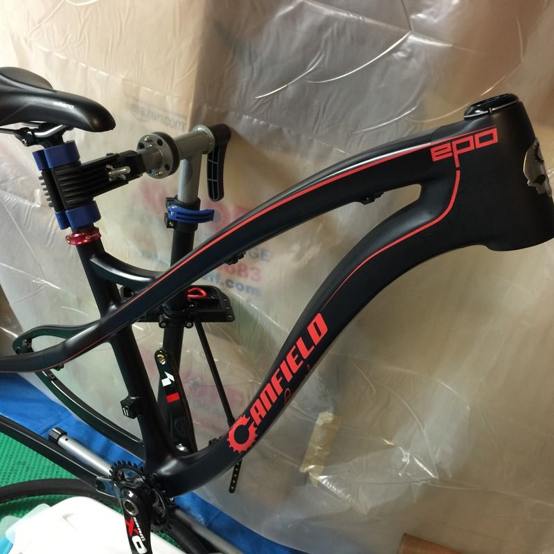

    Quote Originally Posted by Skeeter97 View Post
    Any of you guys running some sort of frame protection yet? This is my first carbon bike so I'm debating whether or not I should do something for the chainstays and downtube
    We are using Xpel Xtreme protective film on our EPO demos and I've been using this on all my personal bikes over the past 5 seasons. Xpel Xtreme

    Quote Originally Posted by Derek200 View Post
    What does the film do? Just protects the finish?
    It's made to protect cars from small rocks a road debris kicking up and chipping paint. It also protects against small impacts with its absorption properties. Will it protect against everything, no, but it will help tremendously.

    Quote Originally Posted by KillingtonVT View Post
    Thanks for the tip. I'll give that stuff a shot. Just downtube and chainstays I'm assuming?
    I use it in any of the high wear areas as well, (TT, SS and CS). Also 3m mastic tape is our favorite material to protect chainstays from chain slap. Nice and clean looking with a ton of impact protection.

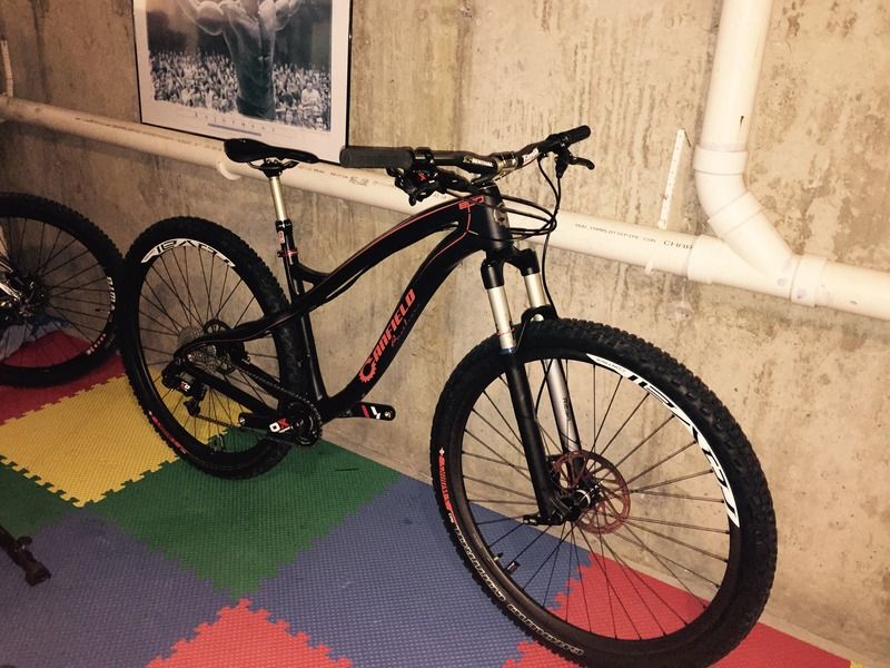

    Hey folks, I am building up an EPO now.
    I'm having a pretty good go at the build up but I am feeling a little confused about getting these SRAM Guide brakes mounted (w/ 180mm rotors).
    Does anyone have SRAMs with 180 rotors on their EPO, and if so can you snap a photo or 3 of the rear caliper mounted up ?
    I have the Pike 140 (post mount), a spacer kit "20 S/ 20 P" as recommended from here:
    https://sram-cdn-pull-zone-gsdesign....r_mounting.pdf
    When I used the post bracket on the pike the calipers did not seem to be fully on the rotor (about 85-90% seemed covered). For the rear I tried the recommended spacers but they also did not cover the rotor so I used the spacers in the bag that seemed work best and then the leftovers I used on the fork (removing the post bracket) and that seems to be better too. Still, I feel like I do not have these brakes mounted perfectly. It feels like a home wrench screwing stuff up.
    I think a picture would really help me get these mounted correctly before I injure myself.

    Quote Originally Posted by mergs View Post
    Not sure if this helps since they're Shimano 180, but I did have to use a small washer on the shorter end of post to get correct bite (silver, right side).

    It kind of does, it tells me I don't think I have the calipers covering enough rotor. I'm looking at my Elixirs on my Chilcotin and they seem to cover more rotor too. I measure about 2.8 mm of space between outside top of rotor and the end of the pad itself. I bet I need no space. Here's what I got now:

  19. #219
    Reputation: mergs's Avatar
    3,581
    fly, I have one of these: https://sram-cdn-pull-zone-gsdesign....40mm_lrg_0.jpg
    Would that work for the rear brake? It seemed like a super tight squeeze which is why I used the spacer kit as depicted in my pics here:

    Quote Originally Posted by flymybike View Post
    The EPO should fit your Guide with only a 180 adapter. We have Shimano brakes on our demo bikes, all brands of brakes mount up with no extra washers or spacers other than the adapter.
    Could you please tell me if I have the adapter oriented correctly? I've had it on both ways. Thanks!

    1,404
    The adapter you linked is for a +40mm to run a 200mm rotor, which would put the caliper in the incorrect position. Running a 160mm can be mounted direct without adapter and you will need a +20mm as imaged below if you are choosing to run a 180mm.

    MostChillin looking at your pictures it looks like you are using the old CPS adapters for avids, the guides are not designed to use the cps washers, just bolt directly to the adapter, which is why you appear to have the caliper to high.

    OK, fellas I really appreciate the help. Based on feedback here, here's what I came up with. The taller spacer is now in the leading edge on both the front and rear and things look to be aligned nicely.
    Canfield Brothers EPO Carbon 29er-img_20150707_172926.jpgCanfield Brothers EPO Carbon 29er-img_20150707_172948.jpg
    The reason why I'm in this pickle was because I have a good friend in the biz and he ordered me the full XX1 drivetrain for this frame and when your bro does that for you you don't pester him with "tech support". (I also feel like I used up all my lifelines with Sean at CB, haha.) Suffice to say my "bro" ordered the brakes and the spacer kits for me and the trick for me was figuring out which way to orient them and that was where you guys all helped big.
    edit: the spacers in each photo are concave and thus I used a convex washer between caliper and spacer.

    Front still looks like the bottom piston is too far off the rotor. Rear seems to look ok but the angle isn't as clear.

    When I'm in doubt about the orientation or spacing needed for a brake mount, I'll put the caliper over the rotor with no adapter or bolts. Push it down until the caliper bottoms on the edge of the rotor, you'll be able to see what space is left and the spacers height should match.

    Yep, agree. I'll run over to my LBS and get the correct adapter from them.

    Thanks for the tip about the Xpel Vin, it's killer! I used the matte on the seat stays, chain stays, top tube, and downtube, and you can barely see it! All my parts are finally here, so I'm excited!
    The only thing I would do different is come all the way up the top tube and contour it to match the headtube. You would never even know there was frame protection without that seam.

    What width did you get of the Xpel? I was thinking just grab several feet of 2", for all the usual areas, but was also thinking a couple feet of wider material for the down tube might be a good idea - all for my Riot.

    I actually bought a 1' sheet of the 36" matte film, and cut out what I needed. I used some poster paper to make templates on the bike, and cut them out of the sheet. It ended up being more than I needed, but I got extra in case I messed up. It ended up being easier than I thought to actually apply. I didn't see the tape rolls in matte though, or I probably would have grabbed it. Would have saved a lot of time.
    My size medium build came in at 25lbs without pedals
    Ibis 941 wheelset
    Schwalbe NN 2.35 rear HD 2.35 front
    XO1 drivetrain
    XT brakes
    Pike 140
    KS LEV 150 dropper
    Such a confident ride I rarely remember that it is a hardtail.
  71. #271
    Reputation: Erock503's Avatar
    Oct 2014
    1,111
    That's the exact wheelset and tire set I'm looking at right now. Nice build man!

    Cranks- Race Face Next w/ AB 32 oval ring
    Fork- Pike 140 46mm offset
    Brakes- XT 160/140
    Tires- front ikon 2.35, rear ikon 2.2. Going to put the 2.35 ikon in the rear and a 2.4 Ardent up front.
    Sorry for the house lean pic, sorta lame for such a badass bike. Will post a proper ride report & pics once I get this chain slip thing sorted out.
    So bling, sick ride, congrats man. You guys with 140 forks are killing me. I love the way the bike handles with 120, but I'm riding it much harder than I anticipated. 140 travel and some beefier stanchions are my next upgrade.
