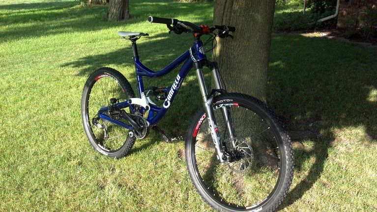

    Here is my 2011 ONE set up as a 650B on front and rear...
    Rode awesome... Thinking about putting it back as a 650b for now until I pick up the Balance later on after the Jedi build

    sullivan, I thought the One didn't fit a 650b rear? wild. interesting. Anything special there?

    Carl- the 2011 ONE has a little more clearance at the front of the triangle. I had about 1/2 to 3/8" tire clearance with the 2.35 Pancetti Neo-Motos. It only brought the BB up about 1/2-3/4" which helped out on the pedal strikes but didn't screw to much on the geometry. I used a 180 Marz. 66 with loads of room for a bigger tire. When I try it again will use a 150mmFox 34 27.5 fork and Hutchinson Toro/Cougar tire(R/F). with a 1.5 angleset to steepen the HA to 66deg
    2012/2013 Ones are too tight to run 650b rear wheels
