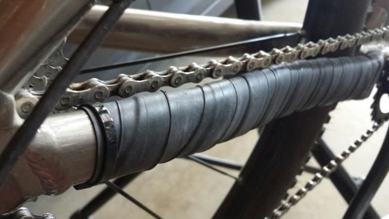

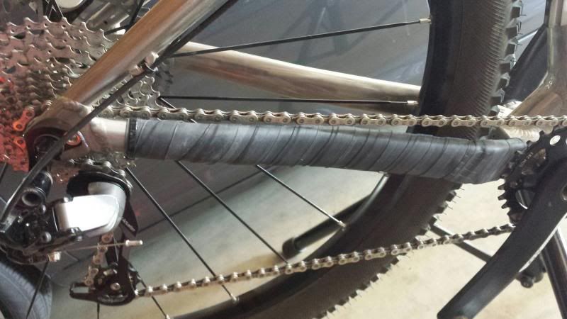

    Just wanted to post pics of what I ended up doing--just an information dump for those looking at options. Ordered the wolftooth bb30 (no dish) 30t direct mount for sram. Here on the bike--tons of room: 30t Wolftooth Ring on a Yelli-wtring.jpg
    Here is a pic of the standard wolftooth direct mount for sram, just to show the dish--it would be mounted the other way around of course. Just didn't visualize the difference when I read earlier about mounting a bb30 ring vs a regular so maybe this will help someone: 30t Wolftooth Ring on a Yelli-wt-ring2.jpg
    Chainline is (near as I can tell with a pair of calipers) about 54.5mm. It shifts fine. I can backpedal without dropping the chain from the largest cog immediately, which is kind of my standard for "OK".
