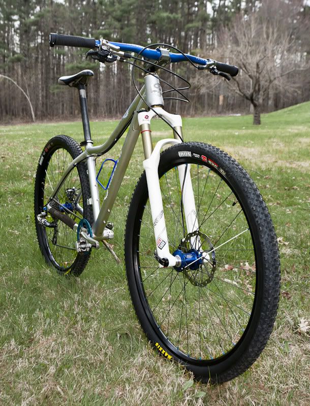

    Have you posted a pic of your whole bike? If not, I'd love to see one if you get the time...
    Here it is:
    It started with Maxxis Ikon 2.25 front and rear for a very short time. I rode most of the season with a Maxxis Ardent 2.4 front, Ikon 2.25 back, which is a killer combination for anything other than hard braking in loose conditions. Now it is in Winter plumage with Ardent 2.4 front and rear.
    Such a fun bike!
    Reputation: Asmodeus2112's Avatar
    593
    Quote Originally Posted by nybike1971 View Post
    Here it is:
    Such a fun bike!
    Very nice! The blue looks great on that frame.
