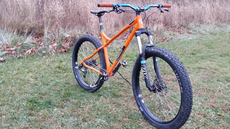

    27.5+ WTB Tires and a 2013 Nimble 9= Fun as h_ll!!!!!..Updated with final pics
    With the new tires sizes coming out for the new year, I decided to play around with my N9 build. Picked up a set of WTB Trail Blazer 2.8" tires and put them on my Blunt SL rims. Not the ideal set up but gave me a good idea where this would take the bike with the proper 50/51mm rim. It has really changed how the bike flows and reduces the rear end bounce when hitting the ruff sections. I will definitely be getting the wider rim as soon as possible. There is about .25" tire clearance on the driveside chainstay. (the tightest area) This has taken a fun bike already and elevated it to a unreal ride! As built below using a 150mm 27.5 Fox Talas the BB height is 12.25" running 170mm crank arms. Plans are to put a 3.1" tire on front and leave the 2.8" tire on the rear..
    Reputation: Fix the Spade's Avatar
    2,739
    That looks great, the bb is higher than I would have thought even with the bigger than normal tyres.
    Fat tyres look like the future!
    522
    Nice!I wonder if the N9 or YS has more clearance?Would run that tire on my yelli if it fit!

    Quote Originally Posted by Fix the Spade View Post
    He also has a 150mm fork on there...

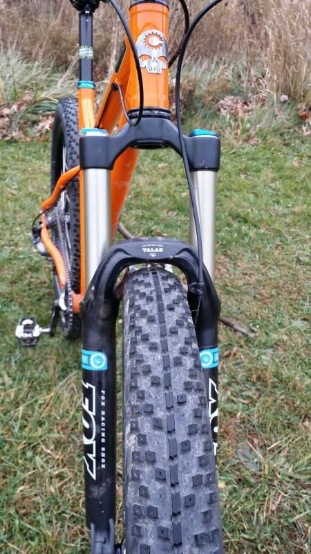

    When you get them mounted it would be great if you could post dimensions of carcass width and overall height. I'm working on a similar build. TIA
    Reputation: rsullivan's Avatar
    845
    Quote Originally Posted by MikenIke View Post
    sure can

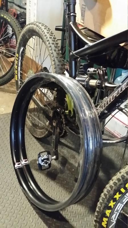

    My Dually rims from Velocity are finally here... will pick them up from the shop on Saturday and start swapping them over... Really can't wait to ride it with the tires opened to full size!!!
    522
    Thanks for the pics Sean!You guys gonna do a ys also?Like the idea of more cush like Ryan said.Take some of the edge of the chop for my aging body!Lol

    What kind of fork is that on the nimble? I hAve to buy a new fork and want lots of room.
    On mine it is a 27.5 Fox 34 150mm travel. I think Sean's is a Marzocchi 44 29er...

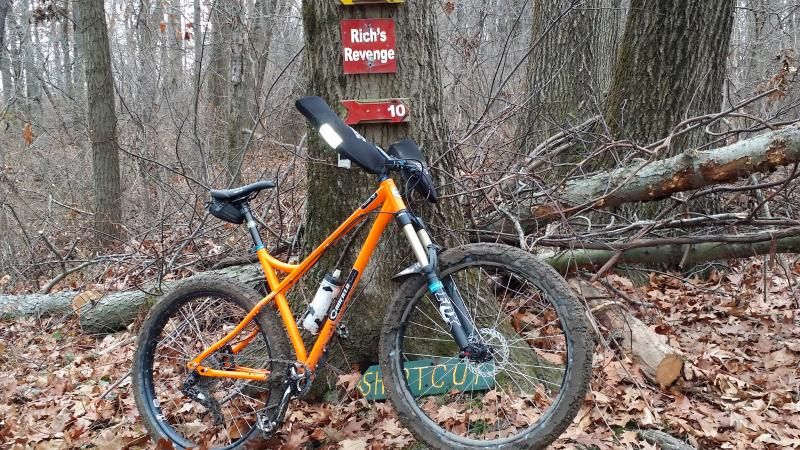

    OK....Here we go...
    Mounted the 2.8 WTB Trail Blazers to the Velocity Dually 27.5+ rims. Rims measure 39mm inside and 45mm outside. At 20psi they measure out to be 2.7" wide per my calipers. I mounted the wheel into both my 2014 Yelli Screamy and my 2013 Nimble 9... both bikes had about 6mm clearance on the drive side and 8mm on the non drive (@ 20psi). To be honest, if you want wider then you should go with a true fat bike. This appears to be a nice middle ground which will increase traction and reduce the trail chatter prone to hardtails.
    Yelli
    Nimble 9
    Full bike...
    Impressions after putting the wider rims is more positive than before... Still playing with the PSI but its looking like I might be able to hit 12PSI in Front and 15PSI in back with a full geared rider weight of 230lbs. Currently with the bike at 20psi it still feels a little too firm in the rear end. Been raining again out my way so may be a few days before I get out on some rooty trails..
    Will possibly buy the VEE Trax 3.25 tire to try on the front. Looks to have a little more traction for the corners...

    Quote Originally Posted by rsullivan View Post
    Thanks... I agree with you... It's hard not to enjoy pushing the progression of MTB bikes and different ways to build them up. I feel it portrays a good representation of the person who owns them.
    I must spread rep before giving it to you again..
    845
    Quote Originally Posted by sennaster View Post
    I wanted a N9 before finding this thread; this upped the ante
    what you waiting for ..... whichever way you build it up, you won't regret it. ... it is a fun bike as a 29er, 27.5 or a 27.5+. Just remember if you run a 27.5 wheel you will have to go with at least a 140mm fork. Need to keep up the BB height. Give Sean or Vin a call at Canfield Brothers and they will be glad to hook you up
    845
    Ride report on the 650b+ wheel set up... Finally got a REAL ride in on the N9 with 650b+ (Dually rims w/WTB 2.8) Ride filled with roots, frozen smooth and uplifted trail surface. Mixed with mud and leaves.
    Running 15psi- Tires felt a little too firm and bouncy. Lowered the PSI to 10 F/R and the bike feels so much smoother and a lot more traction. For the most part the bike felt like a "FAT" bike while riding.Many of the mid to small roots just seemed to disappear as I rode over them. Now granted this is not a true Fat bike but running these tires/wheels has taken a already killer riding bike and elevated it to a Swiss Army bike great for all purposes.
    On a sad note... tried to fit these wheels into my 2015 Balance. They are slightly too tall for the bike. The tire contacted and pressed into the seatstay brace preventing it to turn.

    Reputation: Bigwheel's Avatar
    2,232
    Did you try to mount a narrower tire on the wider rim and fit that? That should work and still have some low pressure benefit. Worth a try.
    A bike by any other name is still a bike.
    845
    Bigwheel..... Not yet. Did not want to dismount the tire since they are set up tubeless... Will have to wait on different rims to come in for the Balance. Might just go with 35mm rims and call it a day... That bike already has gobs of traction due to the linkage design...

    Yes it will fit..... the yelli is equal in spacing as the N9 with the dropouts all the way forward. ..

    Quote Originally Posted by MMcG View Post
    Any update??
    Hey Guys,
    Just wanted to give an update on the WTB i45 rims.
    They Fit!!!!!!! With room to spare
    Pics to come
