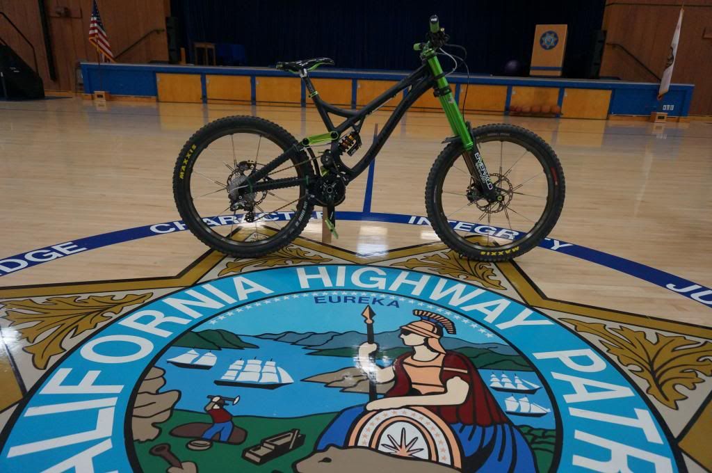

    Ready to shred.
    2014 Canfield Jedi-  Post your pictures and build list:-20140611_193530.jpg
    Jedi - step's Bike Check - Vital MTB
    2014 Jedi Black/Black Large
    Avalanche Woodie
    Fox 40 Avalanche Cart
    Chris King Headset
    Race Face Carbon SIXC 35
    Race Face Atlas 35
    ODI Rogue Grips
    Hayes Prime Pro
    Shimano Zee Shifter
    Shimano Zee Derailleur
    Shimano Zee 165mm
    SRAM 10sp chain
    SRAM 11-26T 10sp cass
    Canfield Crampon Ultimate Pedals
    Halo SAS hoops
    Wheelsmith Spokes/Nips
    Hadley Hubs
    Maxxis Minion DHF front/rear
    SDG Saddle
    Thompson Seatpost
