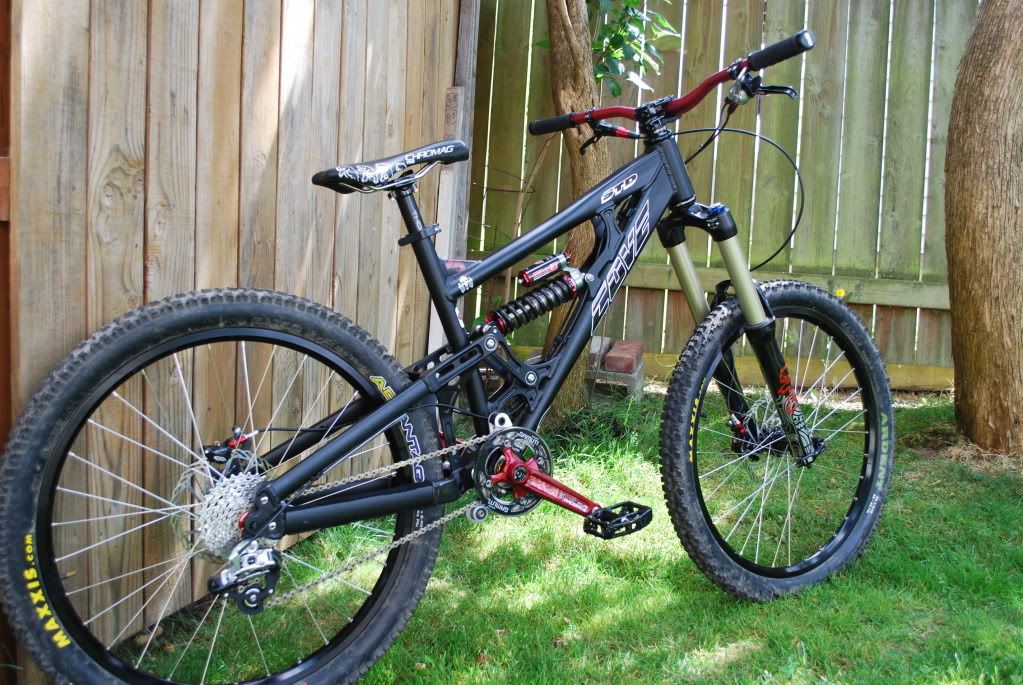

    74
    Took this out for the first time today. It really rips and pedals pretty good too! Weighing in at 39 lbs.

    30
    Looks nice!
    I got out on mine with some riding mates for the first time the other day. It's been 6 months since I rode at all and I still managed to keep up with a load of guys on hardtails on a fairly long journey. Again there was little to challenge the bike so I'll have to search for something more exciting.
    I'm interested to know how many STD owners are running a 1.5" steerer and how many are stepping down to 1.125". Mainly because I'm running 1.5" and having problems with my stem/spacer combination, might need to look for a replacement stem and wondered if anyone could recommend one.

    Here's the one I have set up for MTBGearTech.com. I loved it with the DHX 5.0 but now that I have the Elka on there I'm obsessed with it.

    Your shock is mounted in backwards. It's not a big deal on the medium as it shouldn't contact anything through the stroke. However, the piggy back should be a stationary part of the suspension, attached to the mainframe. The idea is that the shaft end of the shock is lighter and adds less to the unsprung weight as well as moving faster with less chance of cavitation. It's minimal, I know but, but it all adds up and your shock will be happier for it in the end.
  98. #98
    2,050
    Quote Originally Posted by Tobius
    @Tobius
    thanks for your words!!
    that is plsusible!!
    when my elka is back from the update i make the pigipack right way!!
