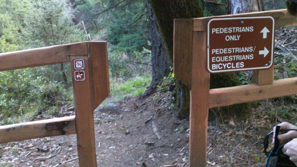

    Paul, Phillip, and the Monterey District Trails Supervisor cross the Hunting Hollow Rubicon.
    The Trails Supervisor praised our work and industry. The objections that the DPR has with the work performed are mostly related to the incomplete state of the construction. However, there are serious concerns which represent a large amount of work to satisfy. Most of that work is something we were anticipating anyway.

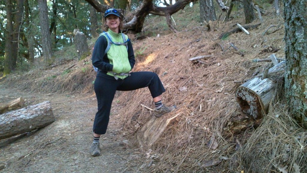

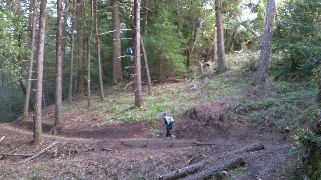

    Close to the parking area Pliebenberg and I built a banked turn (more properly termed a cambered turn I've been informed) on the Jim Donnelly. This type of construction was covered in DPR trail school in a supplement. This was chosen for it's beautiful fit into the landscape. Yes, this was a test case (canary in a Coe mine) for eventual evaluation by the DPR. It has stood for over a year until this contest. Our time of reckoning has arrived.
    The political and practical aspects of the CA DPR interpretation of trail standards are now being rendered by the District Trails Supervisor. As far as cambered turns go, this is pee-wee. I've ridden this at least a hundred times up and down, and it is small and slow fun. It doesn't matter that it works. As it appears in the mission statement of California State Parks, recreation comes last, and fun isn't mentioned anywhere.
    Last I checked, reasons to smile are the most precious resources in the physical realm of the universe.
    Fun to build. Fun to ride. Sustainable. Is this like a fart in church?
    "Okay, this is a structure!"

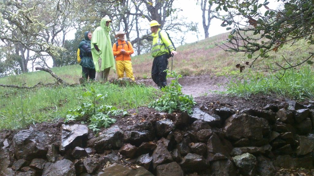

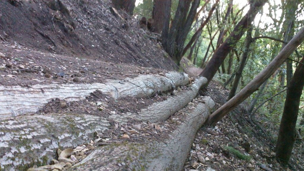

    Here John explained to us how this sort of construction is not approved. He said something about how the turn needs to be flattened out and out-sloped, how there needs to be an in-sloped drain at the top, how much more excavation needs to be done to achieve this, and how we might import some redwood to shore up the inside of the turn to defend it.
    [Edit: There's a lot more to John's comments everywhere in this thread, and in no way can Paul or I accurately represent what he said or means. That said, (if you can follow us here) the construction of an in-sloped drain on the upper leg of a switch-back or climbing turn requires extensive excavation and regular maintenance to continually function as intended. The burden of maintenance is a take on the resource of volunteer labor. An in-sloped drain on an outside upper leg of a turn is by situation cut right into side slopes in excess of 40%. In order to reach the desired 1:1 back-slope enormous excavation is required, and is typically rarely obtained, because the volume of excavation spoils are something like excavation of a swimming pool, and would create an offensive, possibly unstable, scar upon the hillside above, not to mention the damages to established vegetation and habitat. Hence, in order to make the insloped drain "sustainable" (in quotes because even if the follow steps are taken the drain will still clog anyway) a retaining structure could be implemented in a futile attempt to hold the hillside back from collapsing into the drain and sloughing material onto the trail bench. Well, that is a dumb thing to do if you ask me my opinion. You create a situation where you have to dig more to dig more and dig regularly and also introduce man-made and finished materials and hardware that are costly to purchase and transport and assemble/install on a site into what is ultimately an unsustainable position for a critical drainage. It will certainly fail over time anyway. The result of an unmaintained drain on this type of DPR turn is a deeply guttered corner with rubble all over the place. ]
    We have had many equestrians use this turn without complaint. It was explicitly made to accommodate hikers and equestrians. We have discussed this with our local horse riders.

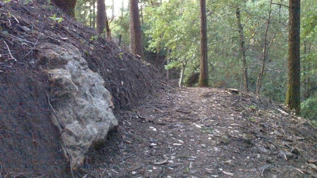

    The tread here is still not wide enough. However there will be some sections where a 36" bench will be allowed to reduce impact upon the trees. John suggested that signs could be placed to advise trail users of narrow areas. The addition of advisory signs to a trail, beyond necessary sign posts are usually not welcome. Why do we need signs to explain what is obvious? Are we concerned that someone will complain? I don't like the idea, and here in this part of Coe I'd expect such offensive signs to be ripped out.
    "Up here is a good place for a choke point."
    A lot of us think that the Jim Donnelly Trail, no matter how wide we make the bench, will develop an 18" wide line in the grass that trail users will favor over time. I'll admit that I've said to myself and other people who don't always see the point of making a 4' bench, that the single-track we like will manifest in a couple of years after completion. Doesn't that sound strange to you too? It remains to be seen. The JDT will be a signature trail that will bear a lot of traffic. It very well might be scuffed enough to stay wide.
    The DPR says that the trails should rely on out-slope to shed water. I agree, but it needs to be augmented frequently and often with every technique possible. A wide bench will become cupped. Dips are essential. John acknowledged this, and did not criticize our drain dips.

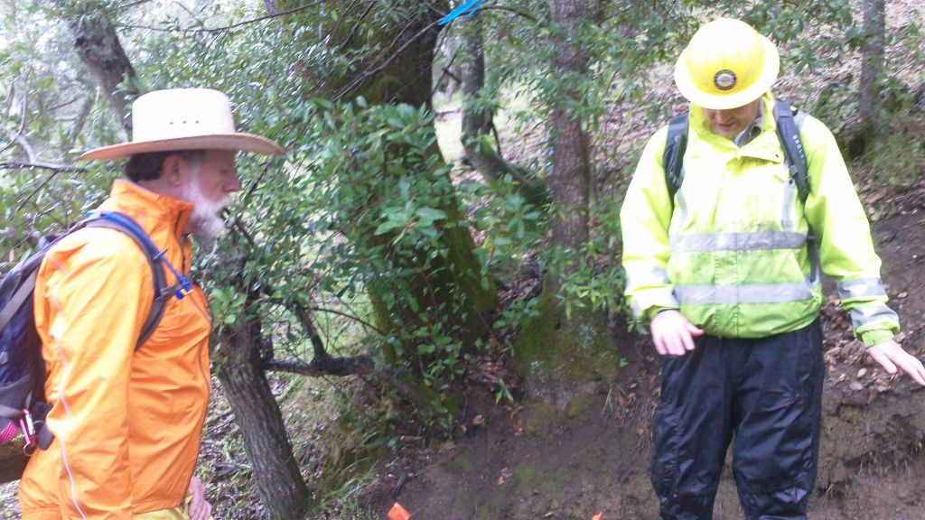

    "What is a pile of small rocks doing here?"
    We had conversation at one point, early in the hike, about the occasional piles of stones placed above the trail-way on the up-slope. This is a common practice. In places where turns are stacked, resulting in trail below construction areas, as on the JDT. Rocks are potentially dangerous missiles, and are not appreciated randomly laying on the trail tread. When you excavate a trail, you excavate many stones of all sizes. Larger ones I encouraged everyone to collect out of the spoil, so that they can be used as construction materials later.
    Stone has many uses in armor, retaining walls, and fill. John explained that these needed to be dispersed. I told him that these rocks are being saved for purposes that will reveal themselves in the future, and most likely to armor the bottoms of drain dips.

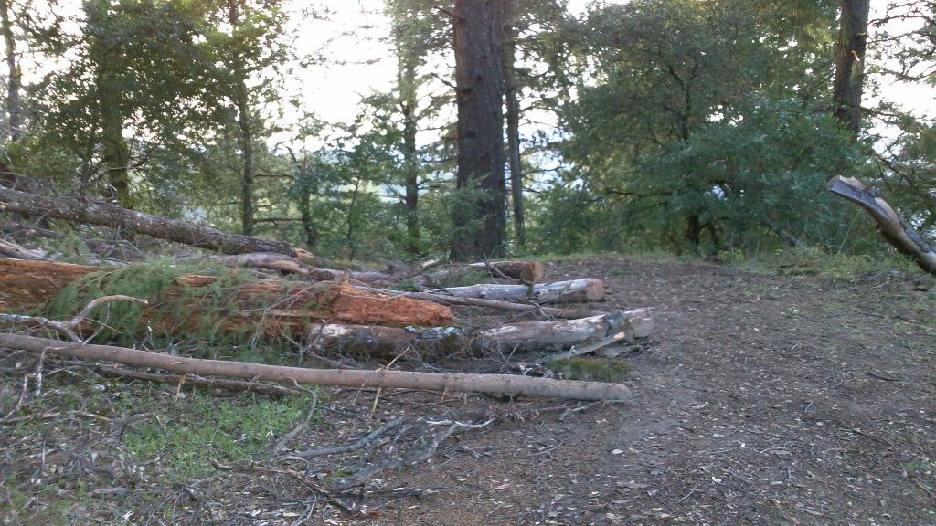

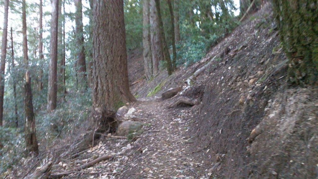

    We view the two right hand switchbacks in the woods on the bottom half of the JDT as unfinished. We view the current state of the trail as a work in progress.

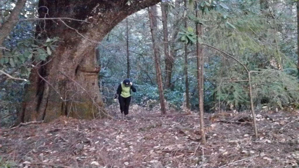

    Ichabod's oak, an area of controversy, is a place where we stopped for a long look at the options for the future. It also offers a good shelter from a storm or the hot sun. We appreciated that the trail was routed here, without realizing that benefit consciously. I did not take photos at the time. I'm sure this will be a place where people will pause on this trail.
    To accommodate equestrians the overhead clearance limit specification is 10'. As you can see from this photo, if we dug the trail bed down more we could easily get 7'. But the extra 3', is going to be hard to find.
    Perhaps I made a mistake in this area, going back a long time ago, when the alignment was chosen to go under this beautiful tree. I recognized the low clearance obviously. But when it came time to cut the limb, I think we were seized with the realization, at least I was, that the limb was too big to cut without a chainsaw and some study.
    The option of digging the trail grade down for clearance was an uncertain prospect, potential roots (but not so likely as the trail is above the tree), and represented a significant amount of work I did not want to commit to right away. A swale below the tree offered a natural bypass which we recognized as the instinctive choice for equestrians. As the trail-way is open during construction, we decided to offer a temporary bi-furcation of the trail here. We became attached to this solution.
    I knew at the time that this was going to be some trouble for us when the trail would be reviewed (as would canary corner). I viewed this as a temporary situation. But I can see that there is a valid point to doing things once the best way. Thing is, here we needed a chainsaw, and volunteers are not allowed to run one in this park (I know it happens in others). Getting staff to come out here and do it has not really been an option until now.

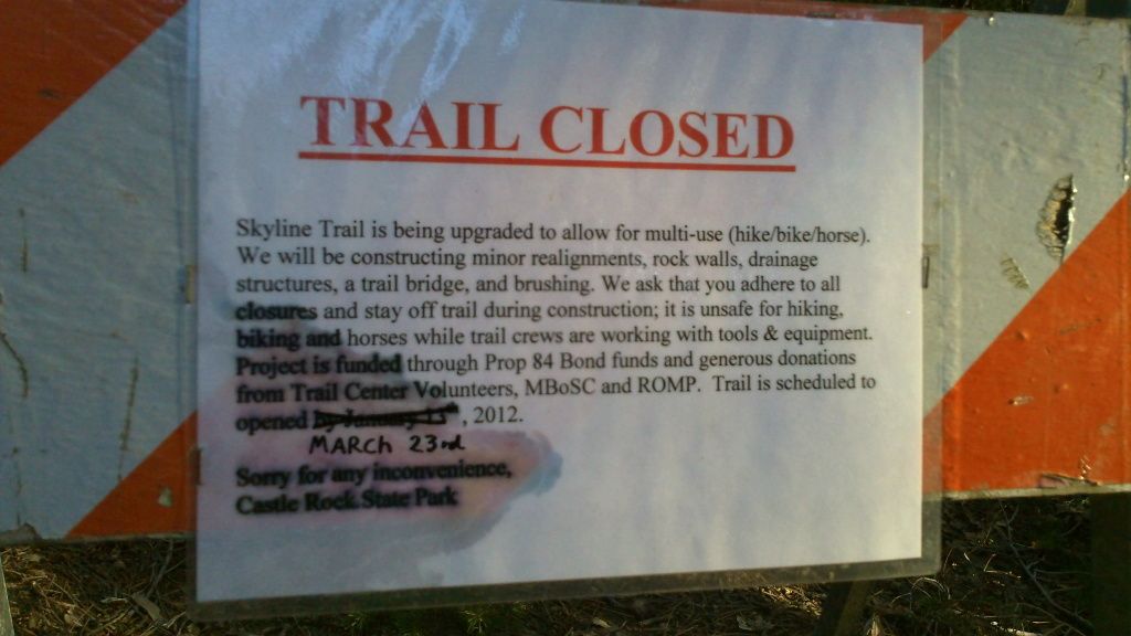

    That antiquated clinging to the 50 year old idea that outslope is all you need, is NOT a State mandate. Everyone here in the Coastal Sector knows that it is proven to not work, unless your trails are in very rocky terrain, and get almost no use (like the High Sierra).
    Grade reversals are the best design, rolling drain / grade dips are bandaids to fix poor design. Slight camber or inslope, properly applied with drainage features before and after, designed properly, are proven methods to increase sustainability.
    The current trail we are working on (the first to undergo a successful change of use with the new PEIR policy) is designed to need NO, zero, nada, zilch, hand or machine maintenance for at least five years.
    You just have someone who thinks that Karl Knapp's theory from 50 years ago still holds, and volunteers do not know enough (sic) for him to consider other techniques.

    Which part is not standard? The signage or the fact that there's 2 trails depending on the users?
    I just saw this on Skyline trail in Castle Rock State park. The left side for pedestrians is not passable to bikers and equestrians, because rocks protrude into the trail with a steep drop off on the downhill side.
    Same sign in Arastradero - bypass of a steep paved section for bikes and horses - less steep singletrack around.
    If so, I owe you one!
    Maybe we should start a new Pliny contest; "Show Us Your Split Trail Signs In CA State Parks".
    I'll pass this around, I don't think it'll change the minds of those in charge in the Monterey District; I've already been told that "Coe has its own set of standards" (or something to that effect).

    This picture is in fact on Skyline trail in Castle Rock State Park. I hiked it the other day and remembered that the split trail was one thing that was seen as questionable on JDT. So I took a picture of it.
    Drew, if you can post your letter that would be good. Especially the part about asking to amending the PEF. I want to write a letter to - not sure when I get to it.

    That's awesome to see that split in Castle Rock SP (I wonder whether it was really necessary). The trail is supposed to officially open tomorrow I thought:

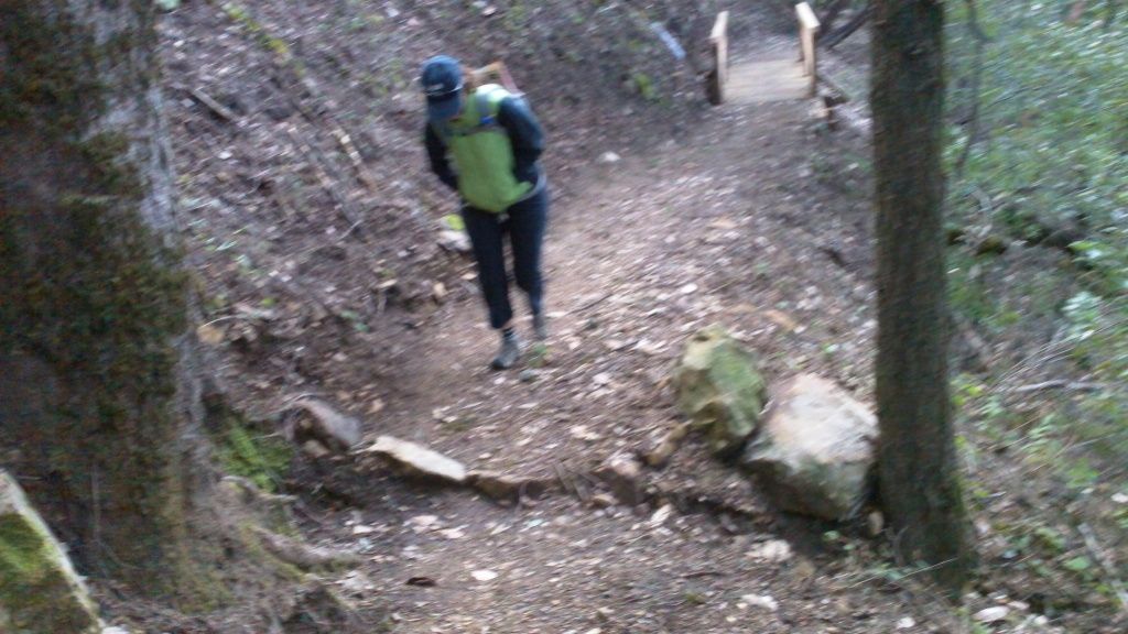

    Update on the bypass on the Skyline Trail:
    Yesterday after work my wife and I went up there to hike and look at the new MUT version of the Skyline Trail and have a picnic-sunset dinner. We've been on this piece of trail many times in the past, long before there was a Bay Area Ridge Trail too. Some thoughts on the bypass there:
    1. It's a long bypass, at least 1/4 mile.
    2. The mountain bikers are prohibited from the better piece of the trail obviously because of the rock formations encroaching on trail down there, making it narrower than the 4 ft wide DPR Class1 MUT standard.
    3. Ironic that the mountain bike club donations to the DPR were use to construct a large fence to prohibit bikes on a section of trail and enlarge/update an already fine trail.
    4. There's a few hundred yards of new trail construction overall, as far as I could tell, which includes some realignments and all new benching.
    5. There are new bridges and retaining walls throughout.
    6. A huge amount of timber in the trail corridor has been removed which is great, and some of the tan bark oak removed looks like it may have been sick with sudden oak death fungus.
    7. This was an expensive project and must have cost way much more than what ROMP and
    MBOSC donated. It will be interesting to see the budget.
    8. We didn't have time to walk the entire new trail yet.
    9. The closed sign at 1.2 miles was still there. We hiked a only a 10th of a mile past the sign on the new bench, and it intersected an old paved driveway which we took right (the Skylione Trail continued to the left), west, to a gate and out to a view point pull out on Skyline and picnicked there.
    10. It appears that the trail opening "ceremony" schedule for the 6th did not happen, and we are awaiting an update from Castlerock SP.

    Concerning the Skyline Trail ,this came in this morning:
    The sign was forgotten by mistake, I'm sending staff up this morning to pull the sign and cut out the down tree near Saratoga Gap.
    Chris
