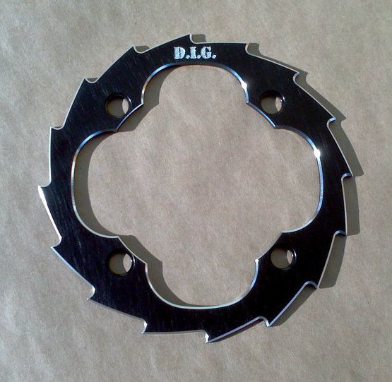

    Finally made my first chainring
    I have been riding my Raleigh XXIX for 5 years and have wanting to make a chainring for it. I have all of the tools, but it has been hard to get around to it while keeping up with the regular jobs. I finally got one done this week. Took it for a spin this morning.
    It's a 33T to replace the one Truvativ ring that came on the bike originally.

    steel or alum ?
  • 11-27-2012
    TheMachinist
    Aluminum. This one is 6061 material that I had in my shop. I am just messing around with the design. I will pick up some 7075 later for strength and wear-resistance.

    TheMachinist
    Ran a lightweight version of the bash guard I made for my old Heckler 10 years ago. I switched that one over to my Blur when I got it in 2007. Now I have a shiny new one. I will have to send one out with the next batch of anodizing to make it look pro.

    Originally Posted by Dion View Post
    Man... if you can design a 30T 104BCD chainring... the 1X and SS peeps will love you long time.
    I just did a quick drawing of a 30T 104 BCD chainring and found the fundamental problem with it. The profile of the teeth cuts into the chainring bolts.

  • 01-01-2013
    TheMachinist
    I got a few pieces anodized. Here is a finished bash guard.
