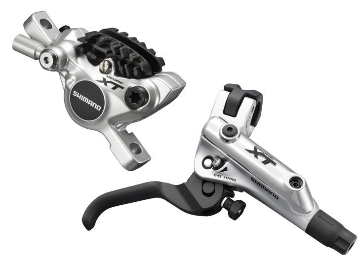

    Reputation: DirtyHank's Avatar
    235
    Are these any good? Are they the latest version of XT's?
    Thanks,
