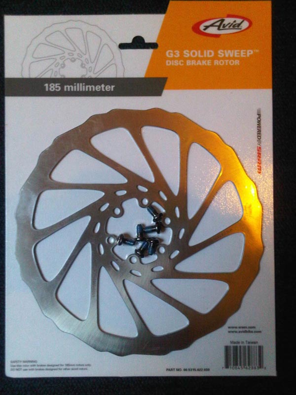

    Ok, if you're asking for specific models I can tell you one you should NOT try, which is Avid Cleansweep G2. The braking surface is narrow, it's noisy with most pads and they vibrate sometimes because of the cutouts in the braking surface.
    BUT... I know that there's another version of this rotor which has no cutouts: Avid Solid Sweep G3
    It's not perfect because the braking surface is narrow as well, but probably better than the original. I haven't personally tried it.
