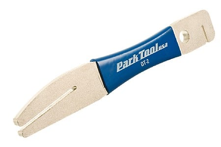

    Park rotor truing fork
    FYI - These work better than an adjustable wrench to straighten a rotor:
    The secret is to bend the center arms - not the braking surface.
