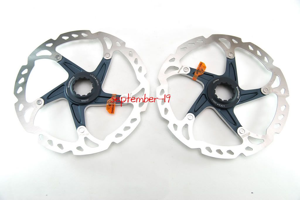

    I like to use these
    or these instead
    mmmmm.....pretty.... And no adapters.
