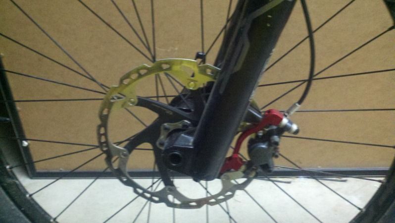

    Oct 2010
    641
    here are the pictures of my setup front and rear
    Juice
    57
    That's brilliant!
