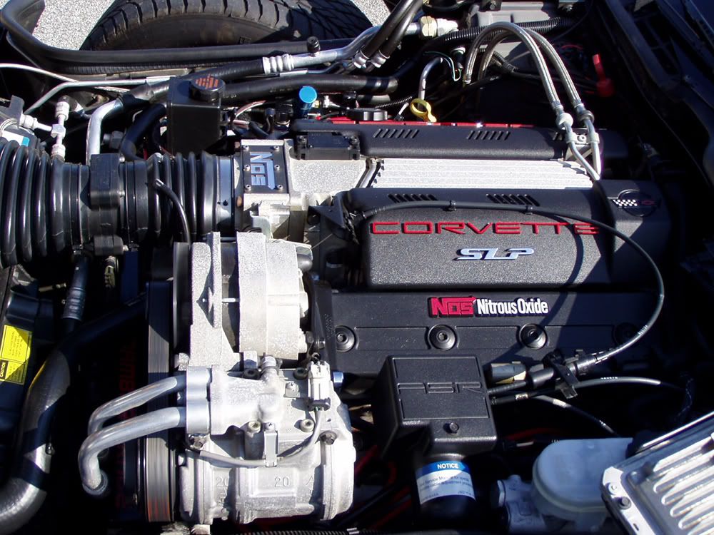

    I would never fabricate anything to sell. I learned my lesson many years ago when an attorney for Nitrous Oxide Systems contacted me about selling throttle body plates with their logo on them for corvette owners with using their product. I made one for myself, and they saw it on my car at a national event. It wasn't but a couple weeks later I received a letter, advising me not to manufacture any for sale. They did not waste much time.You can see it here:

    No...I never sold any. I had a slew of people on a car forum that wanted them, but NOS seemed pretty serious about coming after me.
    As it was, to get my info in the first place, they needed to kleehawk it from my event sigh-up sheet.
    It probably didn't help that they were a participating sponsor of the show.
