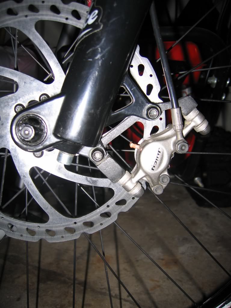

    gosurfninja, the setup for the 203 should look similar to this

    Are your tabs IS mount or post mount? Post mount is the picture above.
    Are you sure you got the right adapter? Are you remember to include the CPS washer stack?

    IS mount Pike with 203mm rotor and adapter.
    ahhhh. i think it's an IS mount (and i have a post adapter).
